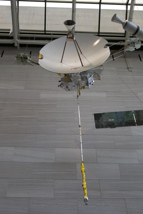

PioneeratNASM
Pioneer H, which is identical to Pioneers 10 and 11, hangs on display at the National Air and Space Museum in Washington, D.C.

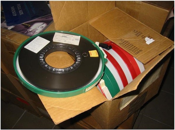

Beyond the theoretical problems facing researchers, another more concrete problem stood in their way: The technical information and recordings of Pioneer data needed to solve the problem were stored either on paper or on 7- and 9-track magnetic data tapes. Identifying these data sources (some of which were literally in boxes under stairwells and in dumpsters on their way to being destroyed), recovering the hardware needed to read the tapes, and converting all of this information to modern media formats was a daunting challenge on several levels, most notably the cost and manpower involved. The Planetary Society helped raise funds to help researchers like Slava Turyshev and his collaborators overcome these challenges.
Pioneer_Anomaly_stairs_data_tapes_3
Much of the Pioneer data were stored on 7- and 9-track magnetic tapes.
