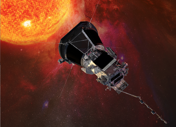

ParkerProbe
The Parker Solar Probe will scream around the sun at more than 400,000 mph and get as close as 3.83 million miles before burning up.
Johns Hopkins University Applied Physics Laboratory

“The spacecraft and most of the payload will be protected by a shield from the Sun’s heat, which will be as high as 500 times what we experience at Earth,” Raouafi says.
The heatshield, made of carbon composites, must be positioned between the spacecraft and the Sun’s corona at all times during close encounters. If the shield is misaligned even briefly, the probe will melt in a matter of seconds.
But why won’t carbon melt under such extreme temperatures? The reason boils down to a fundamental difference between heat and temperature. Temperature describes the kinetic energy of molecules, so higher temperatures mean molecules move faster. But heat is the transfer of energy between molecules.
Just outside the Sun’s atmosphere lies the emptiness of space. Here there are few molecules to collide with Parker’s Sun shield and transfer heat to the device. NASA predicts the shield will only reach temperatures of 2,500 degrees F. While on the other side of the 4.5-inch thick carbon shield, the body of the spacecraft will sit at a comfortable 85 degrees F.
Parker is endowed with four different instruments, which will analyze the Sun’s electric and magnetic fields, plasma, and energetic particles, as well as image its solar wind. The only instruments that must brave the heat of the Sun, protruding from behind the safety of the shield, are electric field antennas and a small plasma detector. The wires of these tools are crafted from robust niobium, and encased in a protective layer of sapphire crystal tubes.
