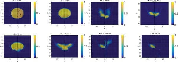

These figures from the study show how two computer-generated meteoroids break up over time while flying through the atmosphere. The left half of each image is a meteoroid with 10% porosity (a measure of empty space), while the right half of each image is a meteoroid with 30% porosity.
M.E. Tabetah/H.J. Melosh
According to the paper, “This process of pressure internalization, new to meteoritic studies, would not have been recognized without a two-material fluid dynamics code.” This unique computer code allowed researchers to generate models that let both air and solid material coexist in any part of the calculation.
“I’ve been looking for something like this for a while,” Melosh said. “Most of the computer codes we use for simulating impacts can tolerate multiple materials in a cell, but they average everything together. Different materials in the cell use their individual identity, which is not appropriate for this kind of calculation.”
