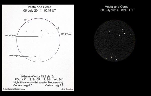

Ceres and Vesta appeared near each other in the sky last July, allowing observers to create sketches of the asteroid pair.
