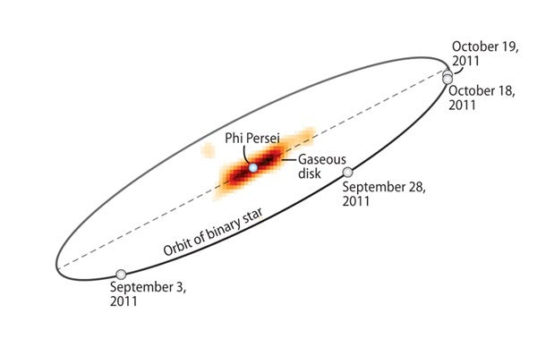

Hot, rapidly spinning stars can sometimes break up as they expan, creating hot, gaseous disks.
Hot, rapidly spinning stars can sometimes break up as they expand, creating hot, gaseous disks.
Astronomy: Roen Kelly; after Mourard et al. 2015 (Astronomy & Astrophysics)

Possible evidence for this picture comes in the form of hot, gaseous disks seen around some hot stars — the so-called “Be” stars, where B refers to the temperature spectral type and little “e” means that the star shows emission lines. We think gas at the equator of a fast rotating star gets nudged out of the photosphere and into orbit, pushing on material that left earlier until a little disk forms. The accompanying photo illustration is a real infrared image of such a gaseous disk we recently captured using the CHARA Interferometer on Mount Wilson. Occasionally amateur astronomers discover normal B stars that all of sudden become Be stars. But how can the gas disk appear so suddenly, within a few weeks? We someday hope to take a picture of this happening in real time with CHARA to find out.
