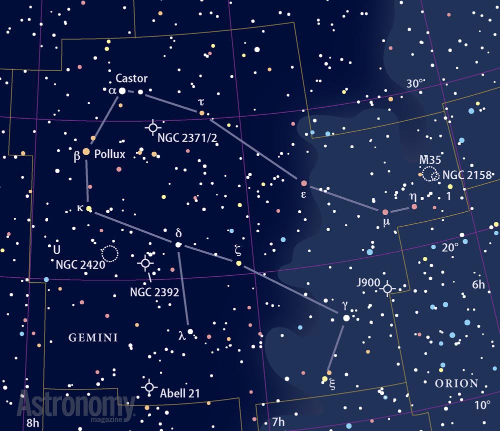

Gemini
The constellation Gemini is home to both the double star Wasat (Delta [δ] Geminorum) and the Medusa Nebula (Abell 21).
Astronomy: Roen Kelly

This week’s first small-telescope target is a pair of winter double stars. The first, Wasat (Delta [δ] Geminorum) is an easy naked-eye star that sits in the middle of the constellation Gemini the Twins.
The primary shines at magnitude 3.5 and is white. Its much fainter companion glows at magnitude 8.2 and appears orange. The pair’s separation is 6.8″. Although that distance won’t challenge any telescope, be sure to use a magnification of 100x or more to split the two components.
The name Wasat comes from the Arabic Al Wasat, which means “middle.” This may refer to the center of the constellation (more specifically, one of the twins — Pollux), or to the star’s position, less than 0.2° from the ecliptic, the Sun’s apparent path through the stars as seen from Earth.

This week’s large-telescope target is the Medusa Nebula, also known as planetary nebula Abell 21 and Sharpless 2–274 in Gemini.
It lies 4.3° southeast of magnitude 3.6 Lambda (λ) Geminorum.
Although the nebula has a moderate listed brightness — magnitude 10.3 — it can be tough to spot through an 8-inch telescope unless your sky conditions are ideal. That’s because it’s huge for a planetary nebula — 615″ across.
If you can pull it in, expect to see a fat, discontinuous arc of nebulous material with numerous dark gaps. A wedge on the northern end and a round region due south are the nebula’s brightest areas. An Oxygen-III filter really will help with this object. Step up to a 16-inch telescope to get a really good look.
