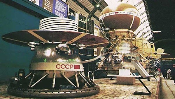

A model of the Venera 13 spacecraft and lander (foreground) on display in Moscow.
NASA
