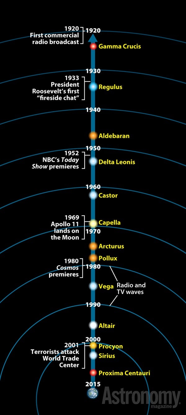

Spacebeacon
Any response we might make to alien signals only would accompany the TV, radio, and radar signals that have broadcasted our existence for decades.
Astronomy: Roen Kelly
