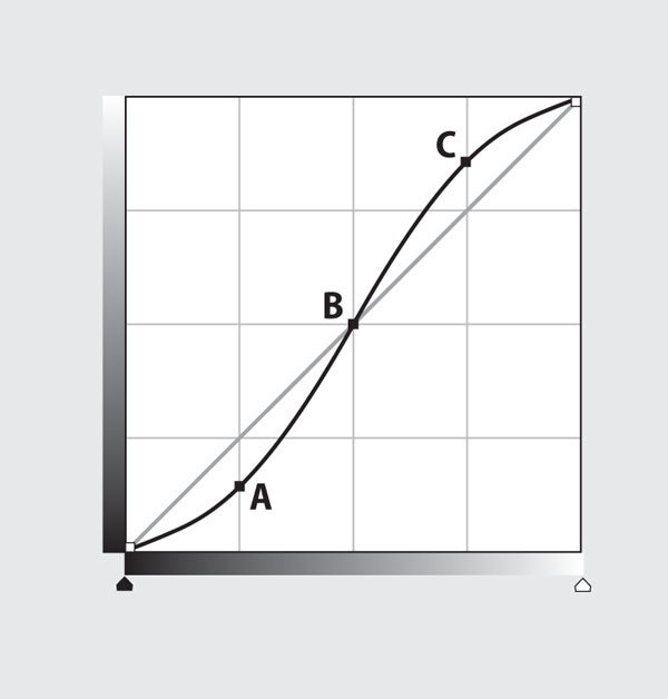

Step 4: To make something happen, remember that Lab Color increases saturation when you increase the contrast of either the a or b “Curves” line. To increase the contrast with “Curves,” simply make an S-shaped curve.
It is critical to have each half of your S be equal. If you don’t, you will change the color balance of your image. The easiest way to make sure that they are even is to use the grid lines in the “Curves” box. Pull down and anchor on the first line, and then pull up and anchor on the third line when the middle of the curve intersects the center of the graph. (See the image above.) Nothing could be easier!

In Photoshop‘s “Curves” box, you must have each half of your S curve equal the other half. To do this, pull down and anchor Point A. Then, pull up and anchor point C when you center point B. Astronomy: Roen Kelly
