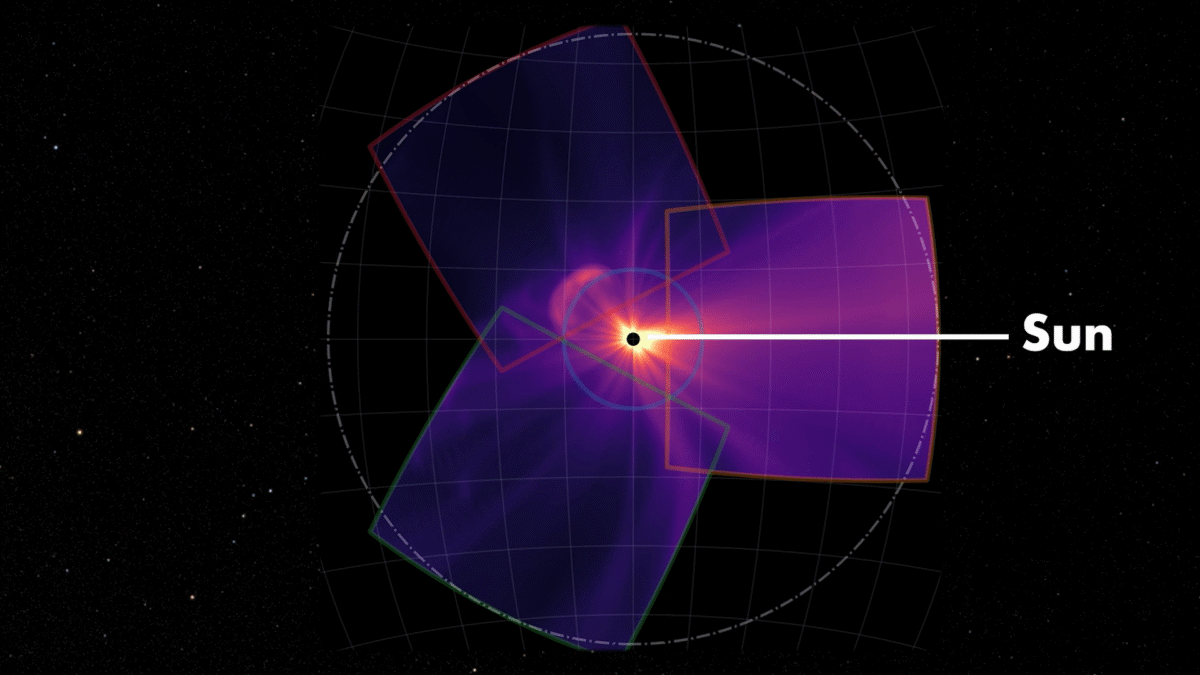

The three WFI observatories will simultaneously acquire data that will look like a trefoil (three-pointed) pattern on the sky when the data from each observatory is combined into a virtual image. As the spacecraft orbit Earth, the trefoil pattern rotates on the sky and builds up the full 90° circular PUNCH field of view with a size of 18 to 180 solar radii.
PUNCH fields of view
PUNCH images will virtually combine a doughnut-shaped inner view of the Sun (blue circle) with three square-shaped views of the corona (green, red, orange squares) to fully visualize how the Sun affects the inner solar system. Credit: NASA’s Goddard Space Flight Center
