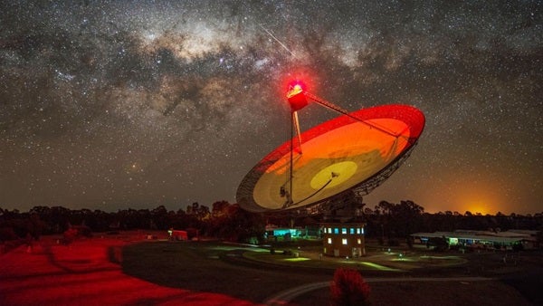

Located in Austrailia, the CSIRO Parkes Radio Telescope picked up the strange signal stemming from Proxima Centauri.
CSIRO/A. Cherney
On 29 April 2019, the Parkes Radio Telescope in New South Wales, Australia, picked up an unusual signal while searching for signs of intelligent life elsewhere in the universe. The telescope was observing Proxima Centauri, the nearest star to the sun and host to a number of exoplanets that are potentially habitable.
