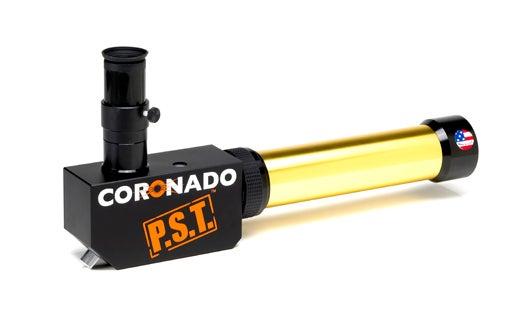

The CORONADO PST, available from Meade Instruments, is a complete Hydrogen-alpha telescope.

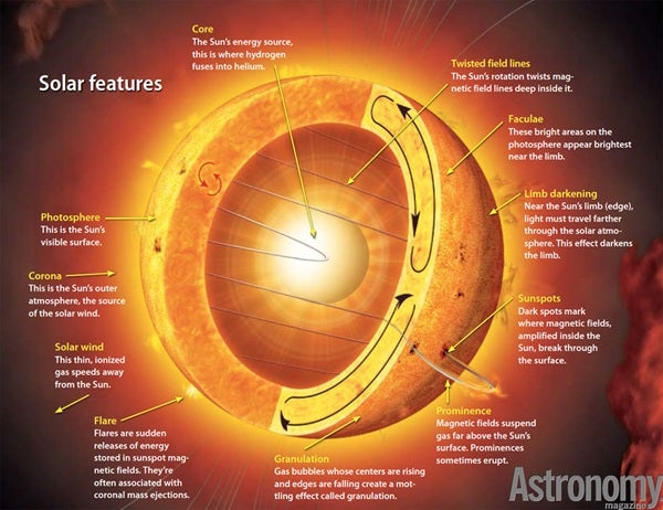

The photosphere is the Sun’s visible surface and is the lowest observable layer of solar atmosphere. Observing the photosphere is easy through visible-light solar filters.
If the seeing (atmospheric steadiness) is good, you’ll spot granulation, which observers describe as a mottled effect. Vast gas bubbles, whose centers are rising and edges are sinking, create granules. Faculae are bright areas visible on the photosphere. Facula is Latin for “little torch.”
Faculae appear all over the disk, but observers most often see them near the solar limb. There, the contrast between the faculae and the darkened limb is highest.
Finally, look for a phenomenon called limb darkening. We observe limb darkening because the Sun is a sphere. Near what we see as the edge of the solar disk, the light must travel farther through the solar atmosphere. This causes the limb to be dimmer than the rest of the disk.

Sunspots, which are features of the photosphere, come in many shapes and sizes, according to the whim of the Sun’s magnetic field. The field traps gas, slowing its motion and making it cooler than the surrounding area on the Sun’s surface.
Usually, sunspots consist of a dark central region called the umbra surrounded by a lighter region known as the penumbra. The penumbra’s temperature is typically 1,800° F (1,000° C) below that of the photosphere, and that of the umbra between 2,700° F (1,500° C) and 3,600° F (2,000° C) cooler than the photosphere.
