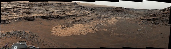

Seven months ago, Curiosity approached “Marias Pass,” where two geological layers are exposed in contact with each other. The rover’s laser-firing instrument for examining compositions from a distance, Chemistry and Camera (ChemCam), detected bountiful silica in some targets the rover passed on its way to the contact zone. The rover’s Dynamic Albedo of Neutrons instrument simultaneously detected that the rock composition was unique in this area.
“The high silica was a surprise — so interesting that we backtracked to investigate it with more of Curiosity’s instruments,” said Jens Frydenvang of Los Alamos National Laboratory in New Mexico and the University of Copenhagen, Denmark.
Gathering clues about silica was a major emphasis in rover operations over a span of four months and a distance of about one-third of a mile (half a kilometer).

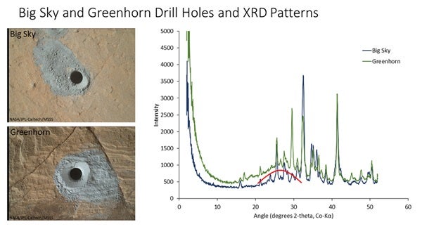

The investigations included many more readings from ChemCam, plus elemental composition measurements by the Alpha Particle X-ray Spectrometer (APXS) on the rover’s arm and mineral identification of rock-powder samples by the Chemistry and Mineralogy (CheMin) instrument inside the rover.
Buckskin was the first of three rocks where drilled samples were collected during that period. The CheMin identification of tridymite prompted the team to look at possible explanations: “We could solve this by determining whether trydymite in the sediment comes from a volcanic source or has another origin,” said Liz Rampe, of Aerodyne Industries at NASA’s Johnson Space Center, Houston. “A lot of us are in our labs trying to see if there’s a way to make tridymite without such a high temperature.”
