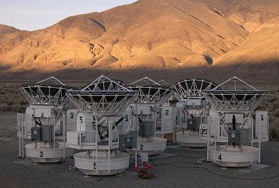

The SZA — an 8-dish, 3.5-meter radio telescope in Owens Valley, California — has the sensitivity to measure the effect. This is impressive considering the temperature is distorted by roughly one thousandth of a degree Kelvin. But searching the sky for these distortions is worth the effort for a University of Chicago team and for their collaborators at NASA’s Marshall Space Flight Center, Columbia University, and Caltech. That’s because the SZ effect is the single most effective way to find every last galaxy cluster above a certain mass — 10,000 times more massive than our Milky Way Galaxy. Usually, the farther away an object lies, the harder it is to find. Remarkably, though, the strength of the SZ effect is independent of distance, so the SZA is capable of finding galaxy clusters as far back in space and time as such structures have existed.
