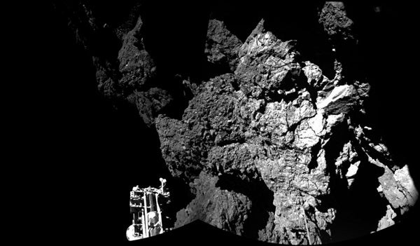

Rosetta’s lander Philae captured this two-image mosaic of the the surface of Comet 67P/Churyumov-Gerasimenko. One of the lander’s three feet can be seen in the foreground.
ESA/Rosetta/Philae/CIVA
