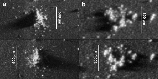

The European Space Agency’s (ESA) Rosetta mission is providing unique insight into the life cycle of a comet’s dusty surface, watching 67P/Churyumov-Gerasimenko as it sheds the dusty coat it has accumulated over the past four years.
The COmetary Secondary Ion Mass Analyzer (COSIMA) is one of Rosetta’s three dust analysis experiments. It started collecting, imaging, and measuring the composition of dust particles shortly after the spacecraft arrived at the comet in August 2014.
The study covers August to October, when the comet moved along its orbit between about 330 million miles (535 million kilometers) to 280 million miles (450 million km) from the Sun. Rosetta spent most of this time orbiting the comet at distances of 19 miles (30km) or less.
The scientists looked at the way that many large dust grains broke apart when they were collected on the instrument’s target plate, typically at low speeds of 2.2–22 mph (1–10 m/s). The grains, which were originally at least 0.05 millimeters across, fragmented or shattered upon collection.
The fact that they broke apart so easily means that the individual parts were not well bound together. Moreover, if they had contained ice, they would not have shattered. Instead, the icy component would have evaporated off the grain shortly after touching the collecting plate, leaving voids in what remained.
By comparison, if a pure water ice grain had struck the detector, then only a dark patch would have been seen.
The dust particles were found to be rich in sodium, sharing the characteristics of “interplanetary dust particles.” These are found in meteor streams originating from comets, including the annual Perseids from Comet 109P/Swift-Tuttle and the Leonids from 55P/Tempel-Tuttle.
“We found that the dust particles released first when the comet started to become active again are ‘fluffy.’ They don’t contain ice, but they do contain a lot of sodium. We have found the parent material of interplanetary dust particles,” said Rita Schulz of ESA’s Scientific Support Office.
