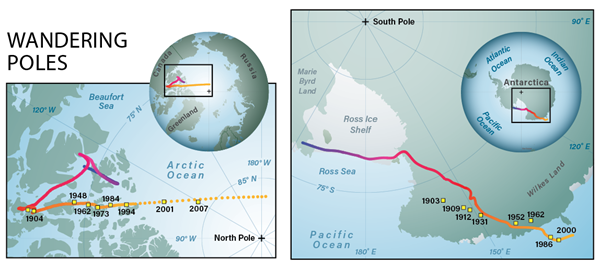

wanderingpoles
The observed locations of the north (left) and south dip poles have been measured only sporadically. Measurements showing their positions are marked with yellow squares. The modeled locations of the poles from 1590 through 2020 are shown as colored lines and circles progressing from blue (1590) to yellow (2020). Although the north dip pole appears to be moving relatively rapidly, a complete magnetic pole reversal does not seem imminent.
Astronomy: Roen Kelly, after NOAA

Lately, scientists have noted that the north dip pole, presently located off the coast of northern Canada, has been migrating toward Siberia at about 34 miles (55 kilometers) per year. Compared with the rate at which the north dip pole has moved in the previous couple hundred years, the present rate is relatively fast. To top it off, the intensity of the field has decreased by about 10 percent over the past 150 years. This has led to speculation that Earth’s magnetic field is about to reverse its polarity.
But let’s step back and consider a few more facts. While the north dip pole is, for now, moving rather rapidly, the south dip pole is not. And although geomagnetic intensity has been decreasing lately, we know from paleomagnetism (magnetization preserved in rocks) that the present intensity is about equal to the long-term average.
Considering all this evidence together and recognizing that the behavior of Earth’s dynamo is difficult to predict, we cannot confidently say that our planet’s magnetic field will soon reverse. We also know from paleomagnetism that reversals don’t happen periodically. They occur rather randomly in time — about once every half-million years or so (on average) — and, typically, a reversal takes a few thousand years to be completed.
