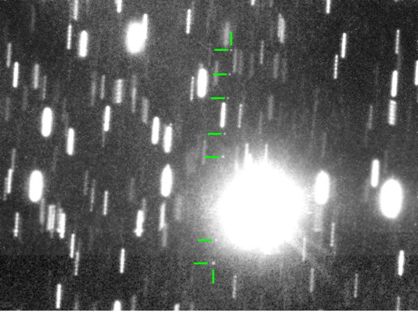

1991 VG (marked with green lines) tumbled through the sky in November 1991. Defying explanation at the time, some astronomers thought it could be an alien probe.

In 1991, Jim Scotti, senior research specialist at the Lunar and Planetary Lab at the University of Arizona, was working on the Spacewatch Project’s second survey campaign. The project was looking specifically for small objects in the solar system.
On November 6, Scotti saw a 10- to 20-meter (33 to 66 feet) object move across the night sky in a way that seemed to indicate it was near Earth. The next night, it was gone, but there was a different nearby object behaving exactly the same. On the third night of observing, neither object was there.
Scotti was confused. A fourth observation finally found one of the objects and revealed what was going on: they were the same object moving in circles across the night sky, indicating an orbit around the Sun nearly identical to Earth’s.
“(It) would be moving across the sky, but it would be moving in little loops,” Scotti says. “It wouldn’t be moving in just a straight line because it’s relatively close to the Earth.”
The spin of the object was way too fast. The sort of rotation rate he witnessed would rip an asteroid apart, according to the model of small asteroids at the time, which described them as loosely-bound “rubble piles.”

Based on its orbit, the object christened 1991 VG was expected to re-encounter Earth earlier this year. And indeed it did — but in that 26-year interim, our understanding of asteroids and meteors improved, as did the sample population of small asteroids like 1991 VG. It turns out, most 10- to 20-meter asteroids tumble like that without falling apart.

Rocket bodies are hollow, and as such, can be pushed around by radiation from the Sun. Their orbits would likely move and shift over time. But 1991 VG was exactly where Scotti and his collaborators predicted on its return in May 2017.
And as it tumbled through, the intervening years had taught us that this wasn’t an alien probe or a human spaceship: it was just another rock in our neighborhood dropping by for a visit.
