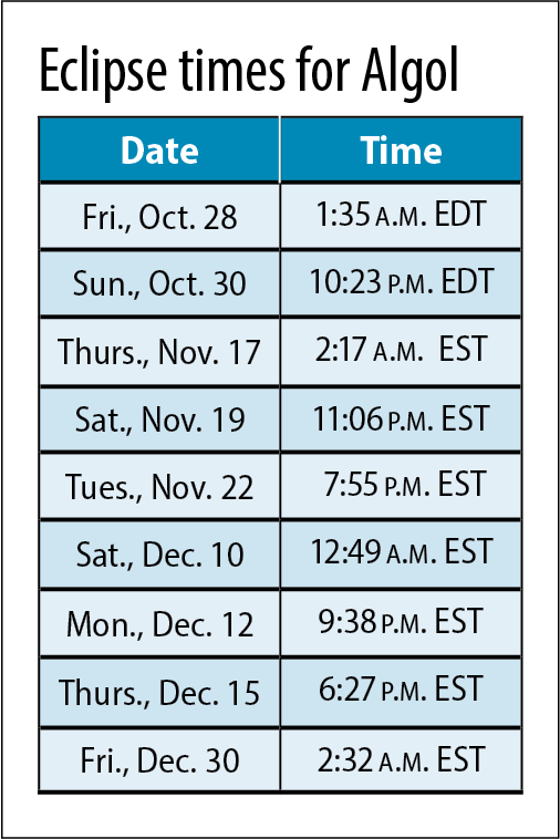

To estimate the changing brightness of a variable star, such as Algol (Beta [β] Persei), it’s best to directly compare it to other nearby stars of known magnitudes (marked above in green). The eclipse times for Algol between late October and the end of the year are listed in the table at right.
Chart: Astronomy: Roen Kelly. Eclipse times: RASC Observer’s Handbook

If you’re up to experiencing an Algol eclipse, here’s what you need to do. First, equip yourself with a clipboard, pencil, red-filtered flashlight, and a watch or smartphone to keep track of time. The clipboard should hold a blank sheet of paper and a copy of the Algol field chart at left. Next, use the accompanying table to select a date and time for an upcoming eclipse. From beginning to end, each eclipse lasts about 10 hours. Fortunately, Algol is nearly at maximum brightness in the early and late hours of the eclipse. You’ll catch most of the action by starting your observations three hours before mid-eclipse and continuing for another three hours afterward.
