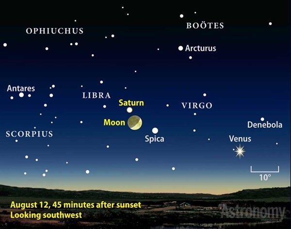

Virgo harbors one other planet these August evenings, and it’s a beauty. Saturn resides at the large constellation’s eastern end, which places it significantly higher than Venus in the evening sky. On the 1st, it stands 20° above the southwestern horizon at the end of twilight. By the 31st, it appears half that high.
When the waxing crescent Moon passes through Virgo before midmonth, it helps create an attractive scene August 12. That evening, the 35-percent-lit Moon forms a triangle with Saturn and Spica. Our satellite appears 5° below the ringed planet and 8° to Spica’s upper left. At magnitude 0.7, Saturn shines almost imperceptibly brighter than Spica.

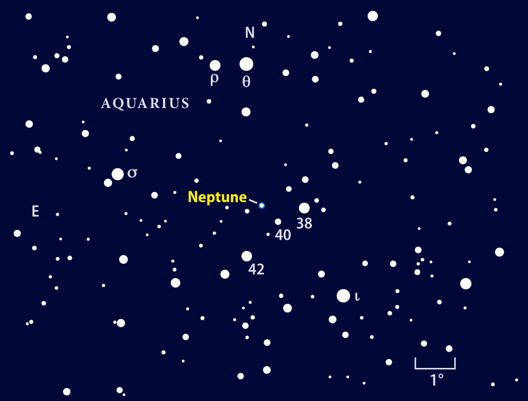

Neptune lies opposite the Sun in our sky the night of August 26/27. Opposition marks the peak of an outer planet’s observing season because it then shines brightest (magnitude 7.8), appears largest through a telescope (2.4″ across), and remains on view all night. For a distant world like Neptune, however, the view doesn’t deteriorate much even a couple of months on either side of opposition.
Neptune lies in the sparsely populated constellation Aquarius. On August 1, the ice giant resides 1.1° due west of magnitude 4.8 Sigma (σ) Aquarii. The planet’s westward motion relative to the starry background carries it 1.8° from the star by the 31st. You can see Neptune through binoculars if you hold them steady (or use a tripod); you’ll need a telescope and moderate magnification to discern its blue-gray disk. The best time to look is when it’s high in the south from around midnight to 4 a.m. local daylight time.

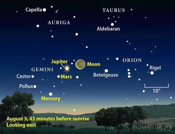

On August 3, the Moon lies 7° to Jupiter’s right. The following morning, our satellite appears 5° to the lower right of Mars, and it passes 5° to Mercury’s lower right the day after that (August 5). The Moon returns to Jupiter’s vicinity August 31.
The brightest of the morning planets is Jupiter, which shines at magnitude –2.0 in mid-August. The giant world lies among the background stars of Gemini and climbs higher with each passing day. By the 31st, it rises around 2 a.m. local daylight time. The observing season for Jupiter is getting underway, and views of the planet through a telescope should be exquisite. In moments of steady seeing, subtle atmospheric features come into view on the world’s 34″-diameter disk.
Mars appears only 5° from Jupiter in early August, but the gap grows to nearly 20° by month’s end. The magnitude 1.6 Red Planet crosses from Gemini into Cancer during August’s final week and ends the month 5° west of the Beehive star cluster (M44). A telescope shows little, if any, detail on Mars’ disk, which measures just 4″ across.
For northern observers, the period from late July to early August is one of the best to view Mercury this year. On August 1, the innermost planet stands 10° high in the east-northeast 30 minutes before the Sun rises. It shines at magnitude –0.1 and grows brighter with each new morning. By the 9th, it reaches magnitude –1.0 and should be just as easy to spot despite appearing a couple of degrees lower in the twilight. When viewed through a telescope during this period, Mercury’s disk shrinks from 7″ to 6″ while its phase waxes from 44 percent to nearly 75 percent lit.

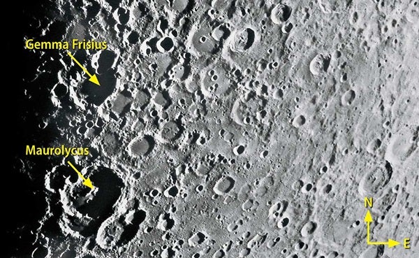

After sunset August 12, the waxing crescent appears in the southwest below Saturn. Turn your telescope on the Moon’s disk, and soak in the breathtaking series of maria in the north before scanning southward across the craters arrayed along the terminator that separates lunar day from night.
Maurolycus, a crater named after a 16th-century Italian mathematician who disagreed with Copernicus’ Sun-centered solar system, sits in the southern third of the disk. The impact that carved out this 70-mile-wide beauty occurred on a relatively thin part of the lunar crust. The blow fractured the crust, creating pathways for lava to seep up and smoothly pave the floor around a complex of central peaks. The impact wiped out half of a crater that lies immediately south of Maurolycus and another one to the northwest.
As the lunar bombardment continued, newer impacts broke up and softened older features. The small craterlets on Maurolycus’ floor are the freshest, but can you figure out the sequence of impacts that created the group on the crater’s northwestern edge? Although the picture above helps, your own observations on the 12th and following evenings are the best way to get the time line straight. A similar story plays out on the crater group anchored by Gemma Frisius a short hop to the north.
As Full Moon approaches, you should see a ray from the distant crater Tycho crossing Maurolycus. Use high magnification to spot this subtle stripe.

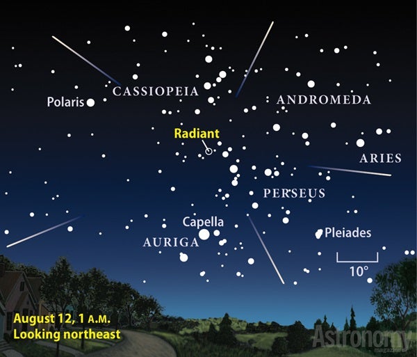

The Perseid meteor shower will be at its best before dawn August 12. Not only does this year’s top shower produce lots of meteors — up to 100 per hour under optimal conditions — but it also reaches its peak with the Moon out of the sky. From mid-northern latitudes, the waxing crescent sets shortly after 10 p.m. local daylight time the previous evening.
If predictions hold, the highest rates should be on display from eastern Europe and northern Asia. Although observers in North America might see “only” 80 meteors per hour under a dark sky on the 12th, rates on the following morning could be nearly as high. Wherever you view from, the hour or so before dawn should deliver the best views.

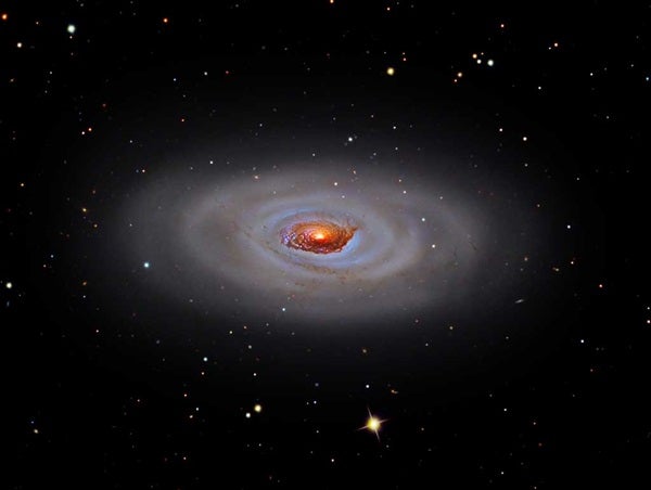

With ISON currently glowing at around 12th magnitude in morning twilight, however, the comet isn’t the best object for honing your skills. An ideal practice target lies in the early evening sky. The Blackeye Galaxy (M64) is a spiral with subtlety to spare. A newbie will need an 8- to 10-inch telescope to clearly see the dark patch that gives the galaxy its name; experienced observers should view with a 4- to 6-inch instrument to reawaken dormant skills.
Is the dark patch round? The eyepiece view should show you that it isn’t. If ISON mimics comets Hyakutake (C/1996 B2) and Hale-Bopp (C/1995 O1), it will show a similar-looking shadow cast by the nucleus onto the surrounding ball of gas and dust called the coma.
Also, which edge of M64’s dark patch looks more diffuse, and which one is sharper? Use a range of magnifications, up to the maximum that seeing conditions allow, to make these small features easier to spot. Sketching the scene also helps train your eye to see detail.

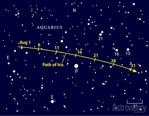

The brightest asteroid to reach opposition in 2013 is not, as it usually is, one of the “Big Four” discovered in the 19th century’s first decade. Instead, 7 Iris is this year’s winner — it glows at magnitude 7.9 when it lies opposite the Sun in our sky August 16. Englishman John Hind discovered this asteroid in 1847 and named it after the Greek goddess of the rainbow.
Iris spends the month in western Aquarius, southwest of the prominent Great Square of Pegasus. This region lies one-third of the way from the southeastern horizon to the zenith in mid-evening and reaches its peak halfway up in the southern sky around 1 a.m. local daylight time.
Your best guide to finding Iris is the 3rd-magnitude star Beta (β) Aquarii. On August 16 and 17, Iris lies just 40′ — a bit more than the Full Moon’s diameter — north of Beta. There won’t be anything else at that position rivaling the minor planet’s 8th-magnitude glow.
The Full Moon passes through this area August 19 and 20, so try to catch Iris before then. The easiest way to find it is to match the stars in your telescope’s field of view with those on the chart below. If a similarly bright background star makes it hard to identify the asteroid, make a quick sketch of the field and come back a night or two later. The dot that moved is Iris.
