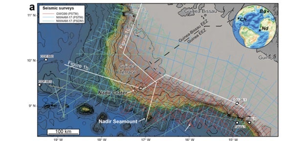

The crater was identified using “seismic reflection” as part of a wider project to reconstruct the tectonic separation of South America from Africa back in the Cretaceous period. Seismic reflection works in a similar manner to ultrasound data, sending pressure waves through the ocean and its floor and detecting the energy that is reflected back. This data allows geophysicists and geologists to reconstruct the architecture of the rocks and sediments.
Scrolling through this data at the end of 2020, we came across a highly unusual feature. Among the flat, layered sediments of the Guinea Plateau, west of Africa, was what appeared to be a large crater, a little under 10km wide and several hundred meters deep, buried below several hundred meters of sediment.
Many of its features are consistent with an impact origin, including the scale of the crater, the ratio of height to width and the height of the crater rim. The presence of chaotic deposits outside of the crater floor also look like “ejecta” – material expelled from the crater immediately following a collision.

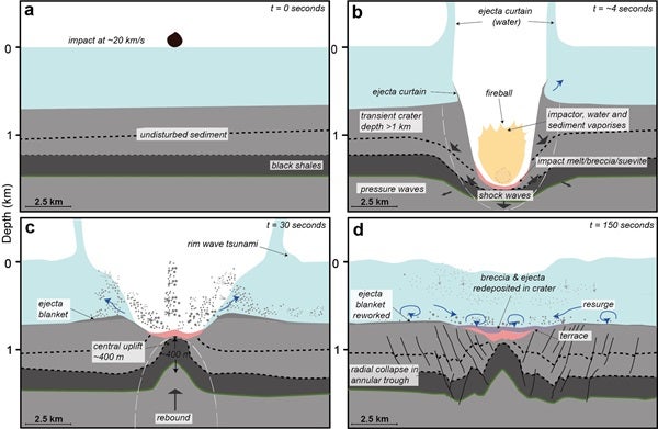

dinosaurkillingasteroidsecondary
This graphic shows how the Guinea Plateau crater is thought to have formed.
We did consider other possible processes that could have formed such a crater, such as the collapse of a submarine volcano or a pillar (or diapir) of salt below the seabed. An explosive release of gas from below the surface could also be a cause. But none of these possibilities are consistent with the local geology or the geometry of the crater.
Earthquakes, airblast, fireball and tsunamis
After identifying and characterizing the crater, we built computer models of an impact event to see if we could replicate the crater and characterize the asteroid and its impact.
The simulation that best fits the crater shape is for an asteroid 0.25 miles (400 meters) in diameter hitting an ocean that was 0.5 miles (800 meters) deep. The consequences of an impact in the ocean at such water depths are dramatic. It would result in a half-mile 800-meter thick water column, as well as the asteroid and a substantial volume of sediment being instantly vaporized – with a large fireball visible hundreds of kilometers away.
Shock waves from the impact would be equivalent to a magnitude 6.5 or 7 earthquake, which would likely trigger underwater landslides around the region. A train of tsunami waves would form.
The air blast from the explosion would be larger than anything heard on Earth in recorded history. The energy released would be approximately a thousand times larger than that from the recent Tonga eruption. It is also possible that the pressure waves in the atmosphere would further amplify the tsunami waves far away from the crater.

Nadircrater
Nadir crater.
