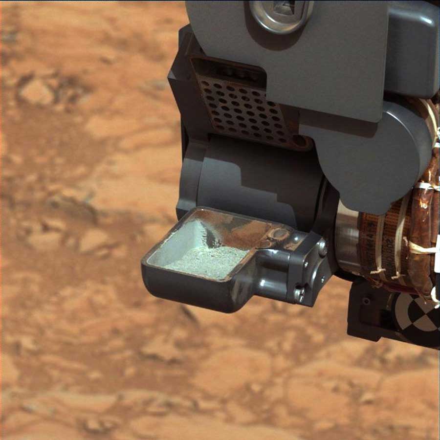

This image from NASA’s Curiosity rover shows the first sample of powdered rock extracted by the rover’s drill. // NASA/JPL-Caltech/MSSS
NASA’s Mars rover Curiosity has relayed new images that confirm it has successfully obtained the first sample ever collected from the interior of a rock on another planet. No rover ever has drilled into a rock beyond Earth and collected a sample from its interior.
Transfer of the powdered-rock sample into an open scoop was visible for the first time in images received February 20 at NASA’s Jet Propulsion Laboratory (JPL) in Pasadena, California.
“Seeing the powder from the drill in the scoop allows us to verify for the first time the drill collected a sample as it bore into the rock,” said Scott McCloskey from JPL. “Many of us have been working toward this day for years. Getting final confirmation of successful drilling is incredibly gratifying. For the sampling team, this is the equivalent of the landing team going crazy after the successful touchdown.”
The drill on Curiosity’s robotic arm took in the powder as it bored a 2.5-inch (6.4 centimeters) hole into a target on flat martian bedrock February 8. The rover team plans to have Curiosity sieve the sample and deliver portions of it to analytical instruments inside the rover. The scoop now holding the precious sample is part of Curiosity’s Collection and Handling for In-Situ Martian Rock Analysis (CHIMRA) device. During the next steps of processing, the powder will be enclosed inside CHIMRA and shaken once or twice over a sieve that screens out particles larger than 0.006 inch (150 microns) across.
