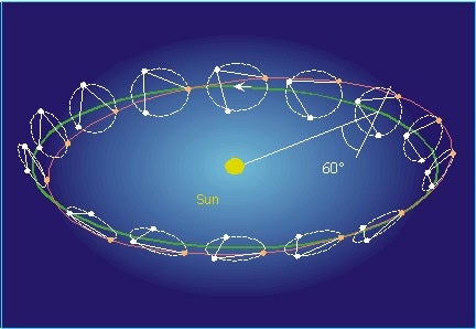

LISA will be made of up three spacecraft, flying in a triangular formation, to create a giant gravitational wave detector larger than Earth. Our planet’s diameter is just under 8,000 miles (13,000 km); each of LISA’s three “arms” (the separation between the spacecraft along the edge of the triangle) will be 1.6 million miles (2.5 million km) long. Inside each spacecraft will sit a small mirror made of gold and platinum. “The whole premise of the LISA mission is this mirror floats in the middle of the spacecraft, where it’s protected from everything: the solar wind, light and radiation pressure, everything. And the only thing it does is it moves if gravity tells it to move. So when it moves, the spacecraft has to follow it, and be able to tell the other spacecraft in LISA where it’s gone and how far it’s gone.”
