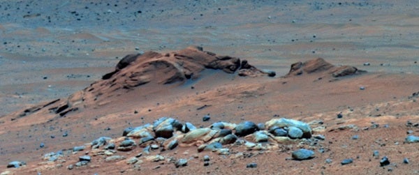

It’s amazing what cleaning your glasses can reveal. A mineral-scouting instrument developed at Arizona State University (ASU) has found an outcrop of rock rich in carbonate minerals in the Columbia Hills of Gusev Crater on Mars. The instrument is aboard NASA’s Mars Exploration Rover Spirit.
What makes the discovery unusual is that Spirit visited the outcrop, dubbed Comanche, back in December 2005. Yet the data pointing to the discovery languished since then because one of the instruments that detected the carbonate minerals was partly blinded by dust.

“Small amounts of carbonate minerals have been detected on Mars before,” said Ruff. “The difference this time is that we’re seeing a couple of large outcrops of rock poking through the soil of the Columbia Hills. The rocks are about 25 percent carbonate by weight, by far the highest abundance we’ve seen on Mars.”
Born of water
Comanche and a neighboring small outcrop dubbed Comanche Spur have the same granular texture and Mini-TES spectral nature. Ruff said they are part of a stack of volcanic sedimentary rocks, draped over the underlying terrain.
“They’re definitely a puzzle to understand,” said Ruff. “The outcrops are very rich in olivine, a volcanic mineral, but they appear to have been soaked in water.” He explains that it’s as if the granular material settled over a pre-existing landscape, then the entire stack was flooded with carbonate-rich water, probably from a hydrothermal source.
