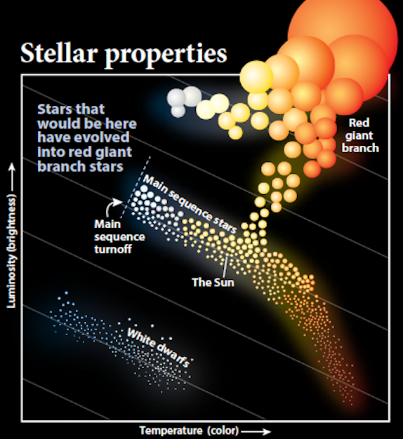

By placing the stars in a globular cluster on a Hertzprung-Russell diagram, astronomers can determine the cluster’s age by looking at the main sequence turnoff point and comparing it with models of stellar evolution.

Astronomers often use a plot called the Hertzprung-Russell (H-R) diagram. It measures the temperature (color) of a star versus its luminosity (intrinsic brightness).
More massive stars are hotter (bluer) and have higher luminosity. The smallest stars are cooler (redder) and have low luminosity.
Drawing a diagonal line across this diagram marks the main sequence. This is where stars spend the majority of their lives, fusing hydrogen in their cores. As the cluster ages, the massive, blue stars run out of fuel first. When a star dies, it stops fusing hydrogen and begins fusing helium. Because this happens at a much higher temperature, the star’s outer atmosphere expands, and it turns into a red giant. As the name suggests, a red giant is reddish in color, so a bright, blue star has now evolved into a bright, red star, and its place on the H-R diagram shifts.
While main sequence stars trace a diagonal line on the H-R diagram, red giant stars create a horizontal line in varying shades of red. This is called the red giant branch. As more of the big stars move onto the red giant branch, the top part of the main sequence disappears. This is called the main sequence turnoff. Because we know how a star’s mass determines how quickly it burns its fuel and where it falls on the diagram, we can use the main sequence turnoff to figure out the age of the cluster. For example, a bright O star will live about a million years. A G-type star like the Sun will live about 8 billion years. A faint, red M star can live 56 billion years. This means that even if it formed at the very start of the universe, an M star will still be on the main sequence today and give us good grounding for our H-R diagram.
NGC 6397 contains more than 400,000 stars, which gives us a lot of points. Using the color and magnitude of each star, we can convert to temperature and luminosity and put them on the H-R diagram. (Note: We technically need to know the distance in order to convert magnitude to luminosity, but since all the stars are the same distance, it doesn’t affect our age estimation.) By studying where the main sequence turnoff is and how far the stars that are no longer on the main sequence have evolved, scientists arrive at the cluster’s age of 13.4 billion years.
