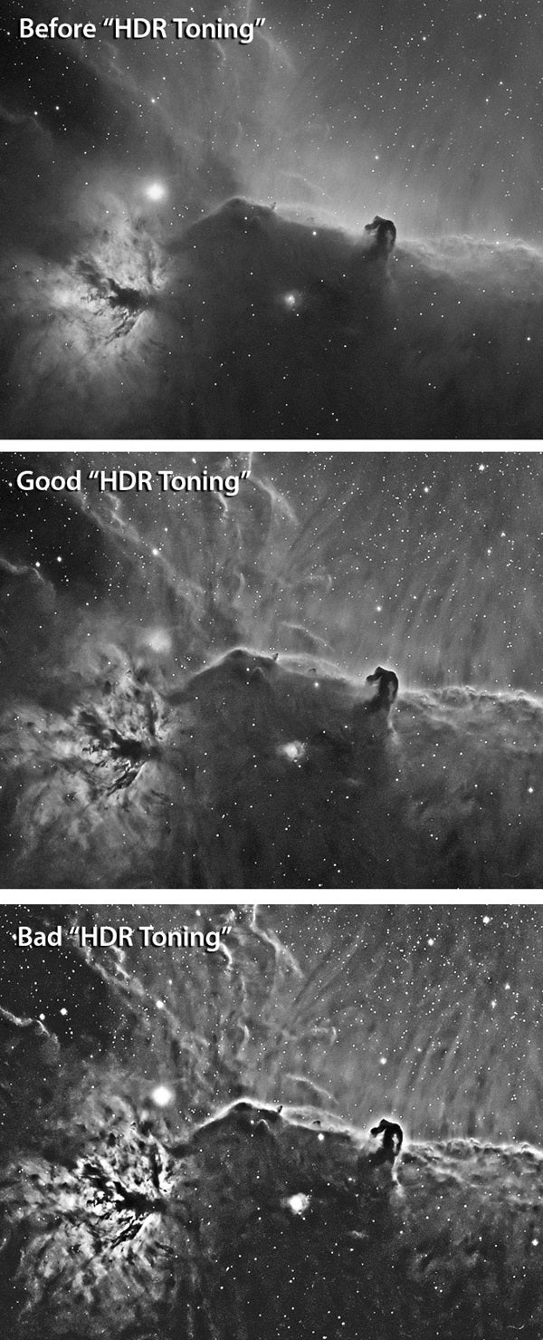

Horsehead-nebula
The Horsehead Nebula appears here after basic processing but before “High Dynamic Range (HDR) Toning” (top), after good use of “HDR Toning” (middle), and after too much HDR use. It can be easy to overdo it, leaving an astroimage looking stark and unnatural, but correctly using “HDR Toning” can improve an already great image. Tony Hallas
