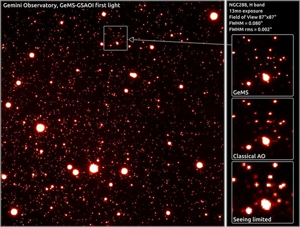

Gemini South’s first-light image from GeMS/GSAOI shows extreme detail in the central part of the globular star cluster NGC 288. North is up, East is right.
On December 16, 2011, a decade of hard work culminated at the Gemini South telescope in Chile when a next-generation adaptive optics (AO) system produced its first ultra-sharp wide-field image. The first target image showed a portion of a dense cluster of stars called NGC 288. This first-light image reveals details at nearly the theoretical limit of Gemini’s 8-meter mirror over an unprecedented large patch of the night sky.

“We couldn’t believe our eyes!” Rigaut said. “The image of NGC 288 revealed thousands of pinpoint stars. Its resolution is Hubble-quality — and from the ground, this is phenomenal.”
Rigaut explained that with the new gain in angular resolution, the crowded city of stars captured in the first light image appears no more densely populated than a typical field in the Milky Way. “This is somewhat uncharted territory,” he said. “No one has ever made images so large with such a high angular resolution.”
The first-light observing run culminated a decade-long effort in instrument planning and development. “We were lucky to have clear weather and stable atmospheric conditions that night,” said Gemini AO scientist Benoit Neichel. “Even despite interruptions of the laser propagation due to satellites and planes passing by, we obtained our first image with the system. It was surprisingly crisp and large, with an exquisitely uniform image quality.”
