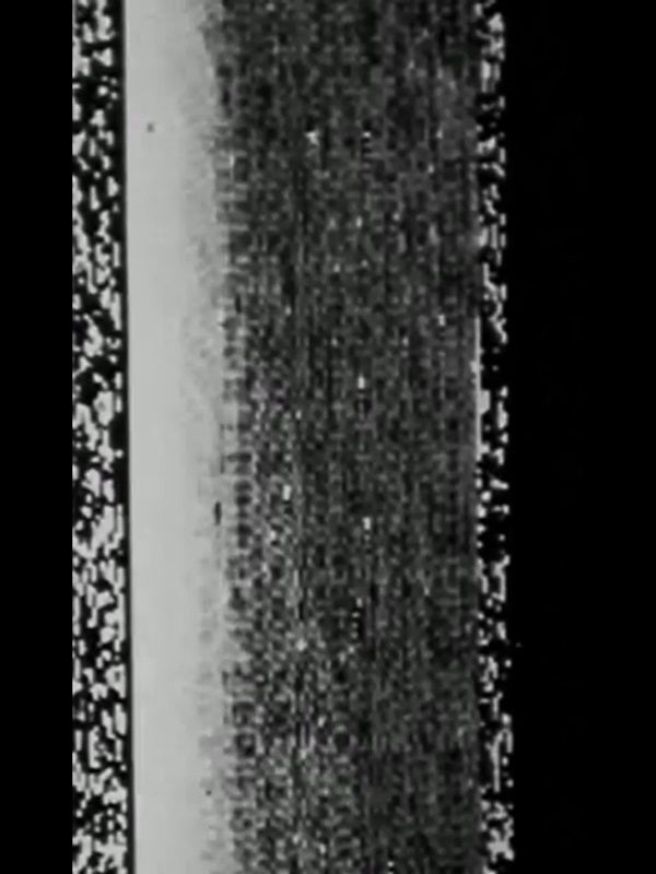

Its sister lander, Mars 3, did make it to the surface in a controlled landing, even navigating through an intense dust storm on its way down. However, the craft only operated for 20 seconds before falling silent, sending back just one uninterpretable image. Still, a win is a win.

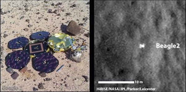

In 2003, the European Space Agency successfully piloted Mars Express into orbit around the Red Planet. In December of that year, the orbiter released its lander component, Beagle 2, for a Christmas Day touchdown. The lander went out of radio contact, and was never heard from again. Scientists assumed the lander had crashed, though they hadn’t received any sign of malfunction.
Then, in 2016, researchers looking over martian satellite photography found the crash site — which wasn’t a crash at all. It turned out the lander had settled, to all appearances, quite gently onto the martian terrain. Its deployed parachute is even visible in some imagery. The problem was its solar arrays, one of which didn’t unfold correctly, leaving the lander unable to send signals back to Earth. Beagle 2 was ultimately tantalizingly close to success, while still completely failing its mission objective.
