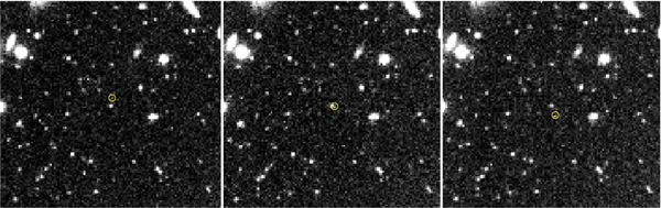

The irregular-satellite haul geared up as astronomers attached wide-field CCD cameras to large telescopes. In 1997, Brett Gladman, now at the University of British Columbia, and colleagues used the Hale Telescope at Palomar Observatory to discover two satellites orbiting Uranus. While this team focused on Uranus, Neptune, and Saturn, David Jewitt, now at the University of California, Los Angeles, and Scott Sheppard, now at the Carnegie Institution of Washington, discovered the majority of the objects around Jupiter. They used both the Canada-France-Hawaii and Subaru telescopes atop Mauna Kea for their searches.

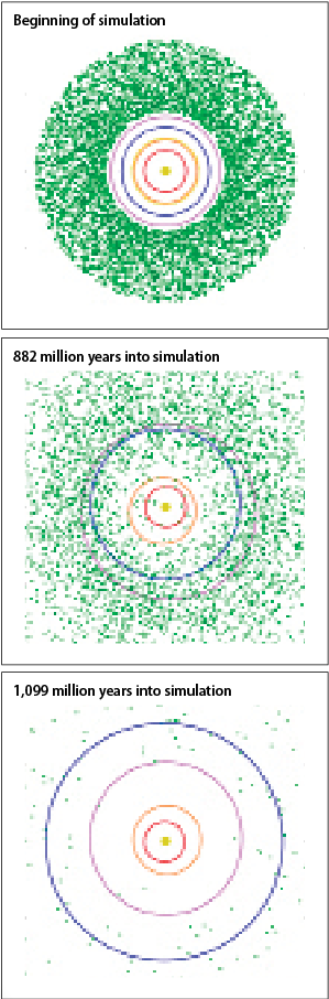

In 2005, astronomers published a hypothesis regarding the giant planets’ evolution. The Nice model (pronounced “niece” and named after the city in France) suggests that the outer planets likely formed nearer to each other and closer to the Sun than they are now. The simulations imply that after the protoplanetary disk evaporated, the giant planets originally existed between 5 and 17 astronomical units (AU, the Earth-Sun distance) from the Sun. Just outside the farthest ice giant sat a disk of planetesimals that extended to about 35 AU.
According to the model, the orbits slowly “wiggled” over time. Then, about 600 million years into the model, Jupiter and Saturn passed through orbits that coincided with a 2:1 resonance (meaning, Jupiter made two revolutions for every one that Saturn made). The combined gravitational effect forced Jupiter, Saturn, Uranus, and Neptune to scatter from each other. As the planets interacted, they tweaked the orbits of any small objects in their paths.
Uranus and Neptune both moved into the planetesimal disk. Thus, small icy bodies scattered everywhere: Some escaped the solar system, some moved toward the inner solar system and collided with planets, others remained in this disk, and the giant planets grabbed some as “new” irregular satellites.
So what’s the proof of this early solar system upheaval? “This model makes predictions about the solar system that match observations,” explains Nesvorny. Its simulated orbits coincide with those of Jupiter, Saturn, Uranus, and Neptune. The icy bodies that remained in the disk match up with some of the objects in the Kuiper Belt — the disk of icy bodies beyond Neptune. Those that moved to the inner solar system could explain the “late heavy bombardment,” which corresponds to craters seen on our Moon’s surface.
