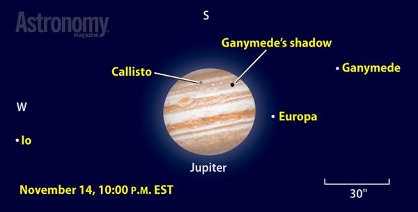

For over an hour in 2033, observers in the U.S. will see Europa and Ganymede cross in front of Jupiter while the planet blocks Io and Callisto.

The answer changes if we allow for some of the moons to be in front of Jupiter at the same time that other moons are behind. When viewed through a small telescope, this lineup would still give us the strange appearance that Jupiter had no moons at all. Io, Europa, and Ganymede line up this way during two windows of opportunity per year. These events last up to 2.3 hours, which is the amount of time it takes Io to cross Jupiter’s disk. The next opportunities to see such a triple alignment from North America are December 18 (1h40m to 3h17m UT), December 25 (3h27m to 5h47m UT), and January 1 (6h38m to 7h33m UT). The next chance during warmer weather will be August 11, 2015, from 7h06m to 9h25m UT.
If you’re interested in searching for these events yourself, the SETI Institute has a tool called “Jupiter Moon Tracker,” which makes plots of the positions of Jupiter’s natural satellites relative to the planet. You can find it at http://pds-rings.seti.org/tools.
Callisto is the wildcard Galilean satellite. It does not participate in the Laplace Resonance, so it could be anywhere in its orbit when the inner moons align. Callisto is in front of Jupiter for about 4° of its orbit and behind Jupiter for another 4°, giving us eight chances out of 360 (because 360 is the number of degrees in a circle), or 1 in 45, that it will engage in the alignment.
Let’s put all the math together. If we typically get three alignments of the inner Galileans every six months, but Callisto has only a 1-in-45 chance of participating, then all four will align about once every eight years. During 2014, Callisto is uncooperative and we will not get a quadruple alignment.
Mark your calendar for August 15, 2021, though. From 15h44m to 15h48m UT on that day, Europa, Callisto, and Ganymede will transit Jupiter’s disk while Io passes behind it. If you’re not in a location to see this event, the next quadruple alignment happens July 28, 2033, from 3h46m to 5h02m UT.
