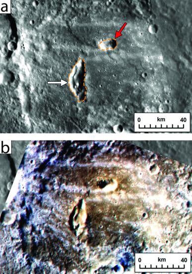

Pyroclastic vents on Mercury
Two pyroclastic vents on the floor of Mercury’s Kipling crater, top, would likely not have survived the impact; they are more recent. The false color image of the same spot, bottom, marks pyroclastic material as brownish red.

A team of researchers, led by Tim Goudge from Brown University, looked at 51 pyroclastic sites distributed across Mercury’s surface. They used data from MESSENGER’s cameras and spectrometers collected after the spacecraft entered orbit around Mercury in 2011. Compared with the data from the initial flybys, the orbital data provided a much more detailed view of the deposits and the source vents that spat them out.
The new MESSENGER data revealed that some of the vents have eroded to a much greater degree than others — an indicator that the explosions didn’t happen all at the same time.
“If [the explosions] happened over a brief period and then stopped, you’d expect all the vents to be degraded by approximately the same amount,” Goudge said. “We don’t see that; we see different degradation states. So the eruptions appear to have been taking place over an appreciable period of Mercury’s history.”
But just where that period of explosiveness fits into Mercury’s geological history was another matter. To help figure that out, Goudge and his colleagues took advantage of the fact that most of the sites are located within impact craters. The age of each crater offers an important constraint in the age of the pyroclastic deposit inside it — the deposit has to be younger than its host crater. If the deposit had come first, it would have been obliterated by the impact that formed the crater. So the age of the crater provides an upper limit on how old the pyroclastic deposit can be.
As it happens, there’s an established method for dating craters on Mercury. The rims and walls of craters become eroded and degraded over time, and the extent of that degradation can be used to get an approximate age of the crater.
Using that method, Goudge and his colleagues showed that some pyroclastic deposits are found in relatively young — geologically speaking — craters dated to between 3.5 and 1 billion years old. The finding helps rule out the possibility that all the pyroclastic activity happened shortly after Mercury’s formation around 4.5 billion years ago.
