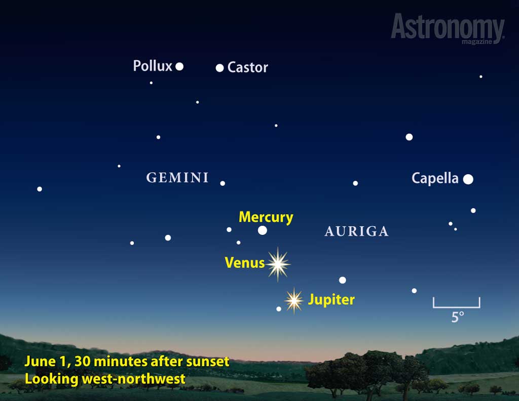

Let’s begin our tour in the western sky shortly after sunset. On June 1, Jupiter, Venus, and Mercury form a straight line angling to the upper left from twilight’s brightest glow. The trio spans just 9°, roughly the width of a closed fist held at arm’s length. Venus shines brightest at magnitude –3.8, followed by Jupiter (magnitude –1.9) and then Mercury (magnitude –0.3). Gemini’s brightest stars, Castor and Pollux, come into view above the planets as twilight fades. The angular separation of the three solar system objects stretches out each evening as Jupiter drops toward the Sun while Venus and Mercury track across Gemini.
Although Jupiter has been a fixture in the evening sky since early winter, its time in the spotlight is nearing an end. The giant planet disappears into the solar glare by June’s second week. It passes on the far side of the Sun on the 19th. Our star actually occults Jupiter that day, an occasion that happens twice during the planet’s 12-year orbit.
Meanwhile, Mercury is heading toward its peak evening altitude for 2013. On June 8, it stands 5° to Venus’ upper left, a degree more separation than on the 1st. Mercury then sets nearly two hours after the Sun, although it has faded to magnitude 0.2. When viewed through a telescope, the planet shows a growing disk with a waning phase. During June’s first week, its size increases from 6.6″ to 7.6″ while its phase dwindles from 60 percent to 45 percent lit.
By the time Mercury slides 2° south of Venus on June 20, the former glows at magnitude 1.2 — 100 times fainter than its neighbor. A wide-field telescope shows both planets together. Mercury appears 10″ across and only 23 percent illuminated. Venus displays a fat gibbous phase on a disk just 1″ wider than Mercury’s.
Venus maintains its brilliance throughout June as it slowly gains altitude. It forms a straight line with Castor and Pollux on June 25, the same day it crosses from Gemini into Cancer.

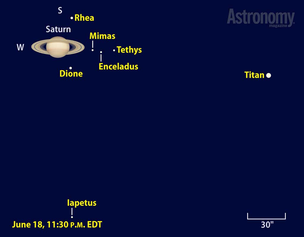

Saturn’s outermost major moon, Iapetus, lies 9′ west of the planet June 1, when it shines at 10th magnitude. It dims by a full magnitude by the time it passes 2.5′ north of Saturn on the 18th and 19th. It appears fainter then because its ice-covered hemisphere is rotating out of view. When Iapetus reaches greatest eastern elongation in July, it will glow at 12th magnitude.
Three additional moons shine at 10th magnitude and show up easily through 4-inch scopes, at least when they’re not too near the bright planet. Tethys, Dione, and Rhea circle Saturn on orbits inside Titan’s. They take 1.9, 2.7, and 4.5 days, respectively, to revolve around the ringed world.
You’ll need an 8-inch scope to spy 12th-magnitude Enceladus. Its 1.4-day orbit keeps it within 35″ of Saturn’s center all month, less than twice the radius of the bright rings. You’ll need to increase the aperture another couple of inches if you hope to see Mimas. This tiny moon glows a magnitude fainter than Enceladus and flits around Saturn in just 23 hours, so it always hovers close to the outer edge of Saturn’s rings.

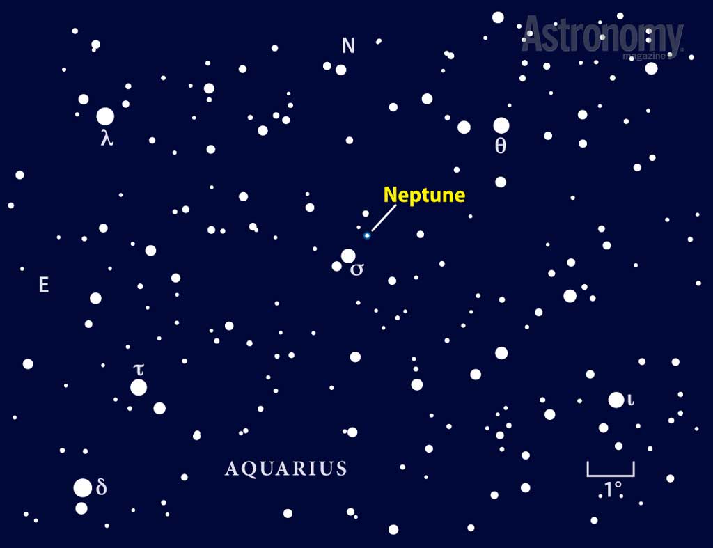

Neptune rises around 1:30 a.m. local daylight time June 1 and some two hours earlier on the 30th. It shows up best shortly before twilight begins, when it lies about 30° high in the southeast. Still, you’ll need some optical aid to spot the magnitude 7.9 planet.
The ice-giant world remains nearly stationary against the relatively barren region of central Aquarius. You can find it 0.6° northwest of 5th-magnitude Sigma (σ) Aquarii. To locate the area, start with four 4th-magnitude stars that form a distorted square: Lambda (λ), Theta (θ), Iota (ι), and Tau (τ) Aqr. Then, draw two imaginary diagonal lines across this figure. Neptune and Sigma lie near the intersection of these lines. When viewed through a telescope, the planet shows a disk that spans 2.3″ and has a noticeable blue-gray hue.

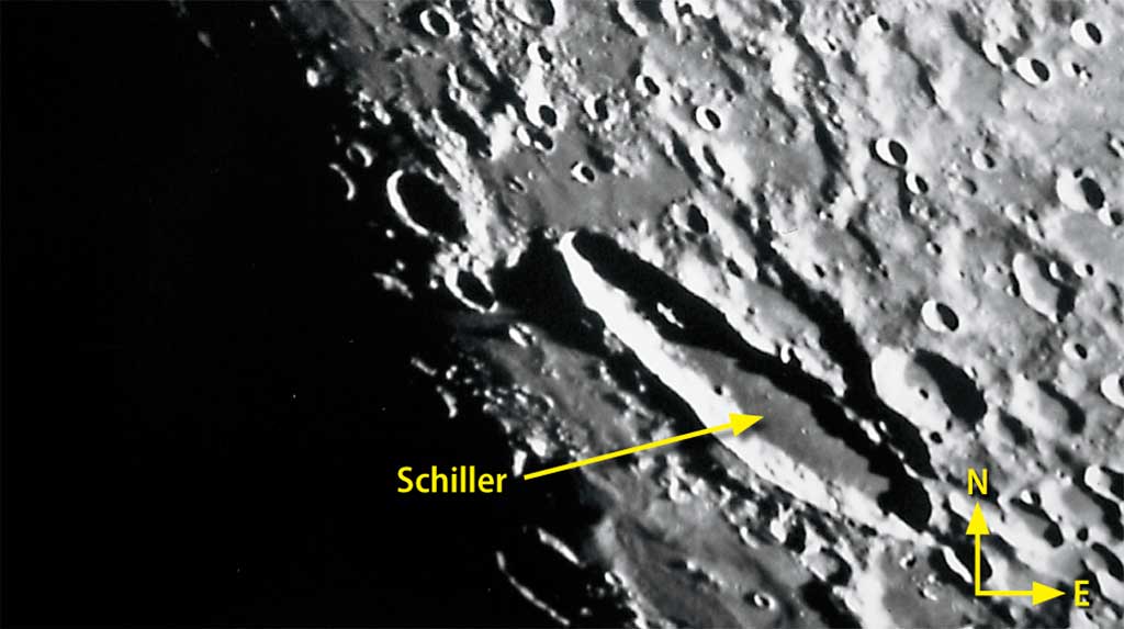

Look near the southwestern limb of a waxing gibbous Moon, and an arresting shoeprint-shaped impact feature will grab your attention. The Sun lights up Schiller on June 19, a few days before Full Moon. The crater’s mostly flat floor and strongly elliptical shape first catch the eye. Although even circular craters appear oval when close to the Moon’s limb, an effect called foreshortening, Schiller seems squashed twice as much as any other in the area.
Until a few decades ago, lunar observers were left scratching their heads trying to explain its form. But research into high-velocity impacts showed that single projectiles hitting at grazing angles can produce some unusual craters, including ones like Schiller. Well after the impact, lava welled up through crustal fractures to form the smooth floor. Messier A in Mare Fecunditatis is the poster child for such low-angle impacts.
To the northeast of Schiller, it’s hard to miss the complex elliptical crater Hainzel. But look closely and you can figure out that separate impacts created it. The northwestern part is a roughly circular feature with a classic central peak. The southeastern section appears to have formed later because its floor better matches the texture and albedo of the overlapping area. Hainzel’s southern component came first. You can tell because the other two overlay it and its rim appears softer from long-term bombardment.

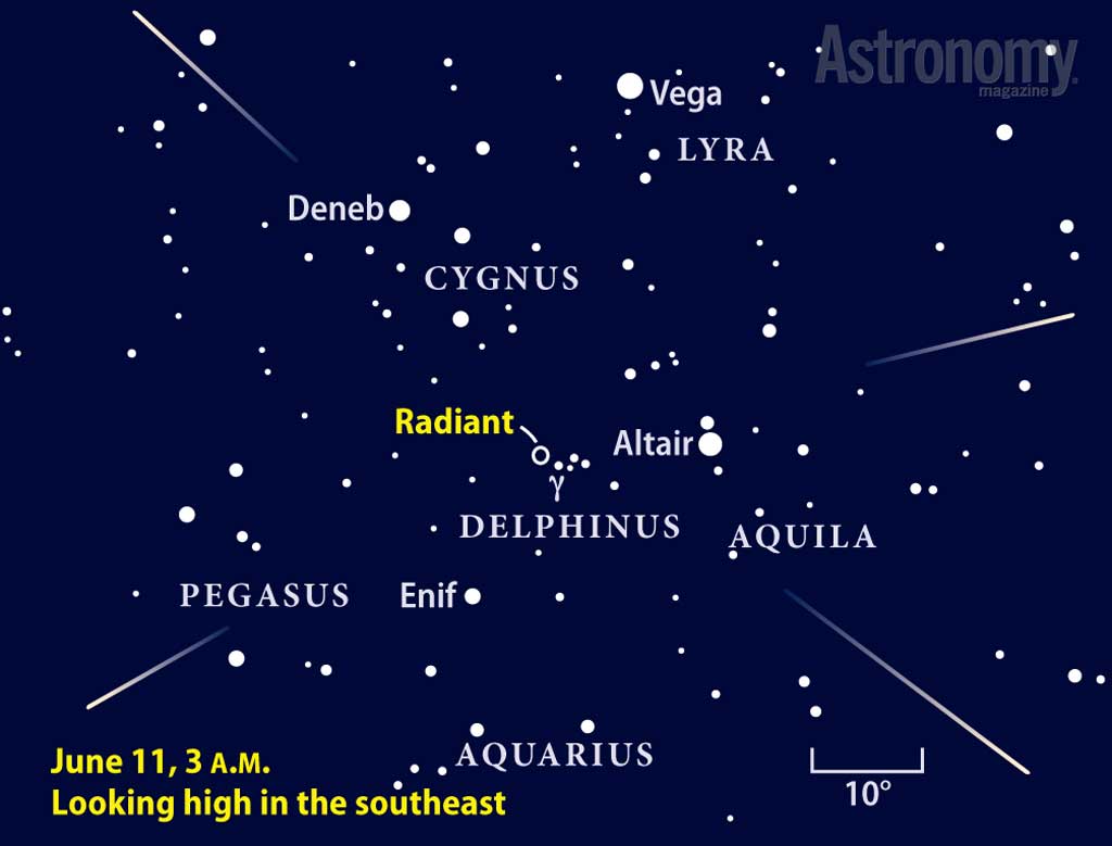

Although June is typically a quiet month for meteors, three experienced observers saw a flurry of activity June 11, 1930. The witnesses recorded meteors from a radiant in the constellation Delphinus, near the 4th-magnitude star Gamma (γ) Delphini.
Despite decades with no reported activity, meteor expert Peter Jenniskens of the SETI Institute predicts 2013 could see a return. His best estimates have a peak occurring June 11 at about 4:30 a.m. EDT. This timing is ideal for early morning viewing from the United States. The radiant then lies high in the sky, and the crescent Moon sets before midnight.
Jenniskens hasn’t made any predictions about the level of activity or how bright the meteors might be, but the one sure thing is that if you don’t watch June 11, you will never know. Astronomers at the International Meteor Organization (www.imo.net) would like to hear from anyone who carefully records their meteor observations that morning.

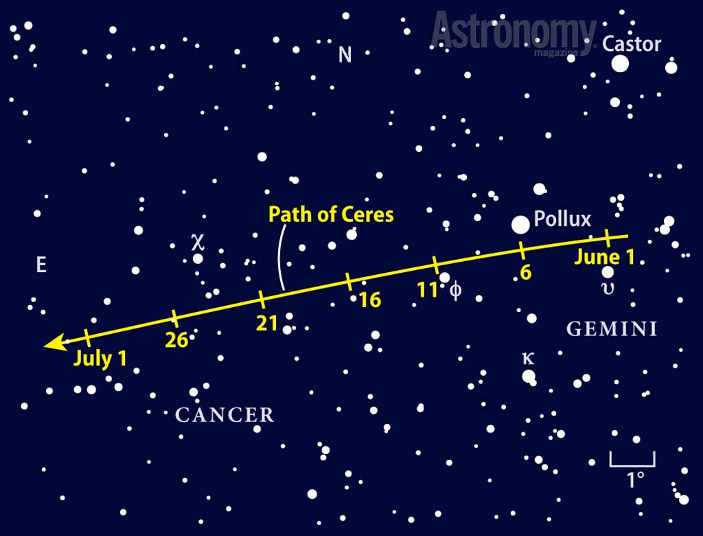

Early June provides a perfect opportunity to star-hop to an asteroid. Just set your scope on 1st-magnitude Pollux and you’re almost on top of Ceres. If you can’t remember which of Gemini’s twins is which, noted astronomy author Ken Hewitt-White suggests this mnemonic: “Castor is closer to Capella, Pollux closer to Procyon.”
Because Ceres sets early, start searching about an hour after sunset. From June 5 to 7, the king of the asteroid belt lies less than 1° south of Pollux. Ceres glows at magnitude 8.8, and only one star in its immediate vicinity appears brighter, at magnitude 8.4. For weekend nights on either side of the asteroid’s close approach to Pollux, star-hopping requires a bit more care and a couple extra minutes.
During June’s second half, 595-mile-wide Ceres crawls across the stardust of Cancer the Crab’s celestial beach. The background stars here appear much the same as the dwarf planet. To make a positive ID, quickly sketch your telescope’s field of view and return a night or two later — the dot that shifted is Ceres. It often can be more satisfying to see the sky change than to take for granted a tick mark on a finder chart.
