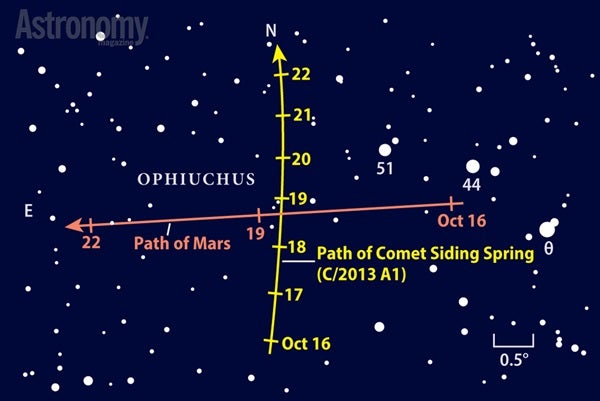

Mars has an even more impressive meeting on the 19th when Comet Siding Spring (C/2013 A1) skims within 81,000 miles of the planet. How rare is this event? Astronomers know of no comet that has ever come closer to either Mars or Earth.
Siding Spring should glow around 8th magnitude — roughly a thousand times dimmer than Mars — so you’ll need a scope and good viewing conditions to spot it. You can bet that the armada of spacecraft orbiting Mars and roving its surface will be watching the comet along with the thousands of excited amateur and professional astronomers here on Earth.

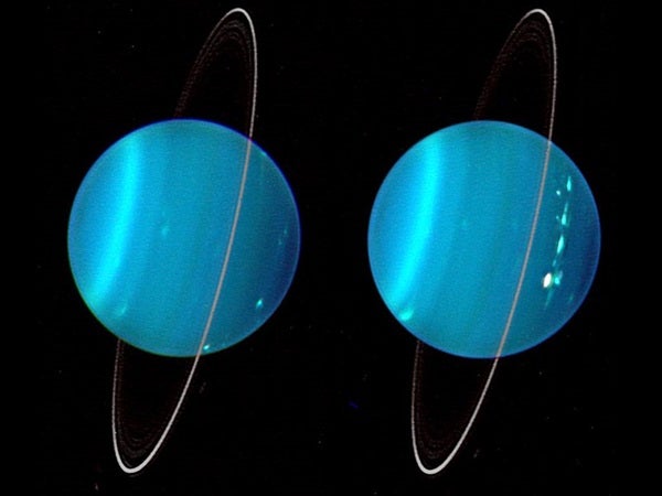

Head one constellation east of Aquarius, and you’ll land in Pisces the Fish, current home of Uranus. The distant world reaches opposition and peak visibility October 7, when it stands opposite the Sun in our sky and thus remains visible all night. Although the Full Moon appears nearby that night, its glare nearly vanishes during the morning hours as it slides into Earth’s shadow. At the height of the total lunar eclipse, the Moon lies 1° from the planet.
Even after opposition, Uranus remains a tempting target. The ice giant shines at magnitude 5.7 and appears highest in the south within an hour or so of midnight local daylight time throughout October. It’s an easy binocular object and even shows up to the naked eye under a dark sky.

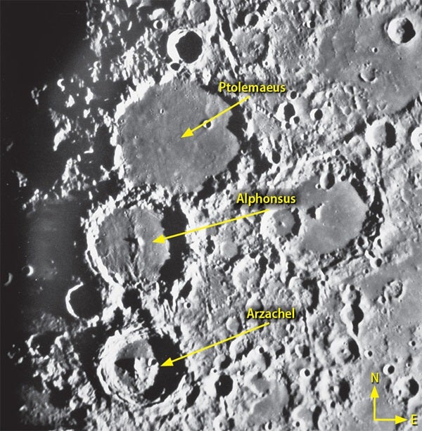

Our nearest celestial neighbor often floods the sky with light. Although many deep-sky aficionados pack up their telescopes around the time of Full Moon, the brightly lit orb offers plenty of thrills to those willing to invest a little time. This month provides a great viewing opportunity on the evening of October 7 because most astronomy enthusiasts will be getting ready for the after-midnight total lunar eclipse. The prominent features don’t change much, however, a night or two removed from Full Moon.
The most distinctive characteristic is the pattern of light and dark areas that resembles a face to unaided eyes. The bright zones to the north and south are crustal highlands, pounded by solar system debris over the eons. The dark circular patches known as maria that give the Man in the Moon its eyes and mouth are huge impact basins. Their dusky color came later when lava from the molten interior welled up and flooded them.
Even the smallest telescope transforms the Full Moon into a real world. Use a filter to cut down on glare, or pump up the power to spread out Luna’s light. The magnificent ray system radiating from the crater Tycho will immediately grab your attention. The impact that excavated this 53-mile-wide bowl launched long streams of lighter highland material that extend nearly to the north pole. Less conspicuous sets of rays emanate from other craters. Generally, the brighter ones formed more recently.
Three prominent white splotches lie scattered among the maria on the Moon’s western half. The brightest of these craters is Aristarchus, which spans 25 miles and lies farthest north of the trio. The energy from its creation punched through a thin layer of lava and blasted out lots of light-hued crust. Copernicus (58 miles across) and Kepler (20 miles across) both have ray systems and large debris skirts draped around them. Although Tycho has a skirt, too, it’s tough to see this light material against the highland crust.

The top event this month involves one of the evening objects. Comet Siding Spring (C/2013 A1) has a historic encounter with Mars on October 19 when the two pass within 81,000 miles of each other at
3 p.m. EDT. The Red Planet then shines at magnitude 0.9, while the comet glows around 8th magnitude. A 4-inch telescope at medium power should provide a great view of the pair from under a dark sky, but you’ll likely need twice that aperture if you observe from the suburbs.

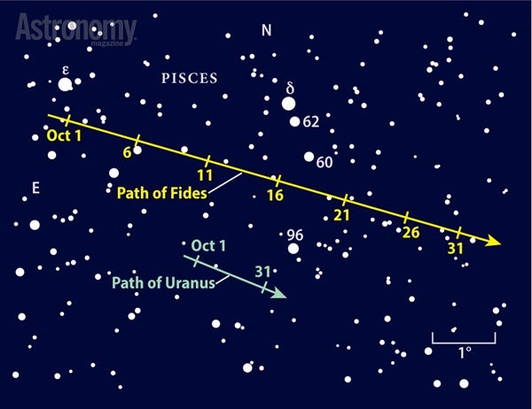

It’s exciting to observe two distinctly different objects near each other. Although bright asteroids often glide in front of a distant galaxy or nebula, this is the first time in more than a decade that we have featured a close apparent encounter between a minor planet and the major planet Uranus.
Asteroid 37 Fides passes within 2° of the giant world during October’s second and third weeks. Uranus currently lies some 1.8 billion miles from Earth, nearly 15 times farther than Fides. But the ice giant planet is nearly 500 times the diameter of its cousin, which spans just 67 miles. Couple that with Uranus’ greater reflectivity, and it should come as no surprise that Uranus glows four magnitudes brighter than Fides.
The pair resides in southern Pisces, an area located about one-third of the way from the southeastern horizon to the zenith in midevening. Two 4th-magnitude stars, Delta (δ) and Epsilon (ε) Piscium, make excellent guides for finding Fides. This object will appear similar to the faintest stars plotted below, so you’ll need to be careful in identifying it. Make a quick sketch of the star field, label the one you think is Fides, and then come back a night or two later to confirm that it has moved.
