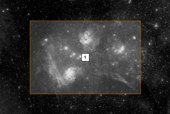

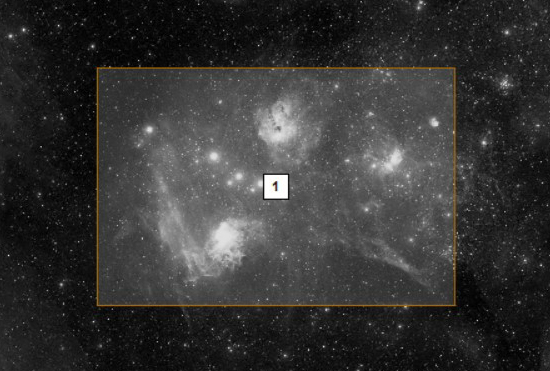

The RedCat 91’s field of view is not quite as broad as my RedCat 71. However, a quick test using the Framing Wizard of the popular automation application Nighttime Imaging ’N’ Astronomy shows the RedCat 91 still covers a respectable field of 4.6° by 3.1° with a full frame camera. This is enough sky real estate to easily frame all of the Andromeda Galaxy (M31), or the rich field in Auriga that encompasses the Flaming Star Nebula (IC 405), the Tadpoles (IC 410), and the Spider and the Fly (IC 417 and NGC 1931).

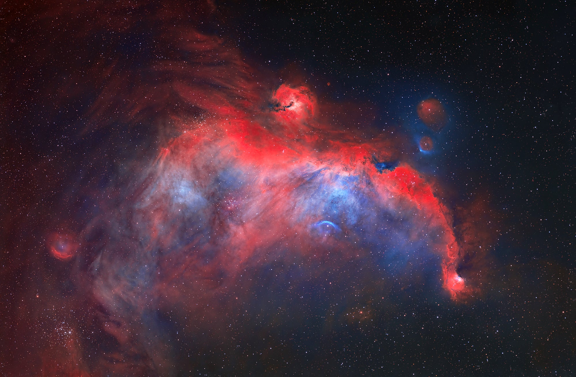

Clouds shut down my evening activities, so first light would have to wait. When I got my clear night, I chose IC 2177, also known as the Seagull Nebula, as my target. For my imaging run I took a set of RGB light frames — 12 frames per filter at 300 seconds each. Next I took a series of Hydrogen-alpha (Hα) frames — nine at 900 seconds each. Finally I shot a series of Oxygen-III (OIII) frames — 12 at 1,200 seconds each. All data captured was binned 2×2 to limit the file size of each light frame. In total, I spent two nights collecting my data.
The first thing I wanted to check was the star geometry: How do the stars look across the entire frame of the image? For that test, I processed the RGB data first, creating a simple RGB image. After enlarging the image, I checked the stars at the extreme edges, and was pleased to see that the stars remained perfectly round across the entire field.
Then, to see this scope’s full capabilities, I added the narrowband Hα and OIII data to the image. The RedCat 91 easily pulled in fine structural details only visible in narrowband light to create an absolutely impressive result.
