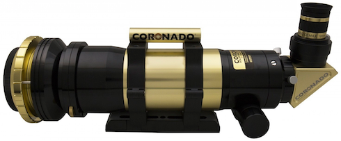

Opening the case reveals the SolarMax telescope nestled in the fitted interior foam. The finish on the scope is a combination of brass and black anodization. It looks great and reminds me of a fine 19th-century instrument.
SolarMax III is, in fact, a 2.75-inch (70 millimeters) f/5.7 refracting telescope with a 400mm focal length. The actual solar filters are mounted on front of the tube assembly, making this an incredibly versatile telescope — but more about that later. As with all solar scopes, SolarMax III lets you directly and safely observe the Sun’s chromosphere in real time. Unlike common full-aperture, white-light solar filters, which allow you to safely view a combination of all of the Sun’s visible light, the SolarMax III provides views of our daytime star specifically in the Hydrogen-alpha (Hα) wavelength.

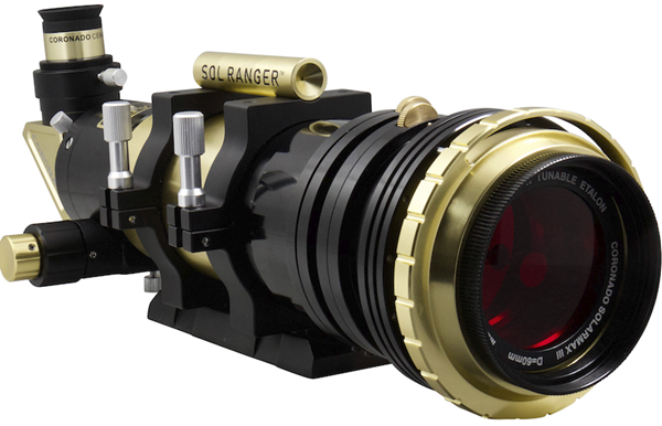

Four filters in this telescope make it possible to safely observe the Sun in the Hα wavelength. When you remove the front dust cap, you’ll see that the objective lens is red. This is where the filtering starts. The red objective reduces or “rejects” most of the light energy entering the telescope.
Directly behind the objective is the RichView Tuner, which sits in front of the first etalon filter. The tuner (it’s not a filter) is mounted in a large brass ring and can be rotated to improve contrast and detail. An inch or so behind the tuner is a small brass knob on the first etalon filter. This is one of two T-Max Tuners. There is a second T-Max Tuner knob farther back at the second etalon filter. You adjust these to fine-tune the etalons and thus bring out additional details. Meade also placed a blocking filter in what looks like a star diagonal, which is attached to a tube that fits in the focusing rack. The blocking filter eliminates more wavelengths of light and produces an image that’s safe to look at.
It takes some practice to get the best visual image through this scope. The SolarMax III is fitted with a high-quality 2″ dual-speed rack and pinion focuser, which allows for both coarse and fine adjustments. I had to pull the blocking filter with its tube about halfway out to get the best focused image. Then I adjusted the RichView Tuner.
When I first looked though the eyepiece, I saw several secondary solar images. Rotating the tuner helped move these to where they weren’t noticeable. While still watching the image, I worked the two small knobs that tune the etalon filters. It was easy to get a fantastic 3D image. Some features on the Sun are moving toward or away from Earth. Light undergoes a Doppler shift as a result. The T-Max Tuners adjust the etalon filters to help compensate for this visual Doppler shift. The end result is amazing contrast and detail.

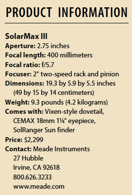

Coronadoproductinformation
