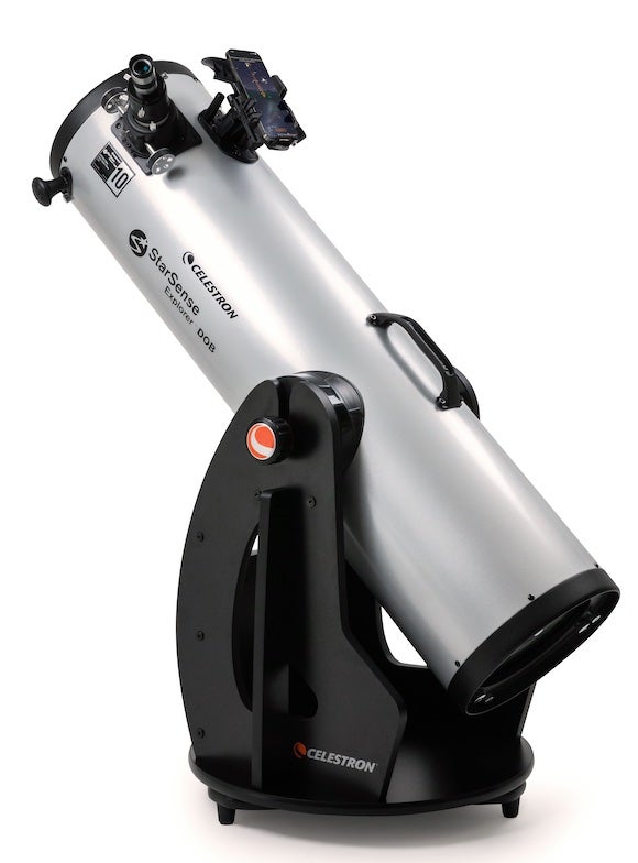

The scope arrived securely packaged in two boxes. Inside one was the optical tube assembly. The other contained the flat parts of the Dobsonian mount and lots of Allen head bolts to connect everything together. The package also contained a box of accessories that included the smartphone dock, a red-dot finder so you could point to an object by eye, an eyepiece rack, the base handle, and an instruction manual. I received a 25mm Omni Plössl eyepiece, a 2″ focuser extension tube, and a 2″-to-1¼” eyepiece adapter.
One nice feature Celestron included was a 2-inch (5.1 centimeters) knob that sits 2 inches (5.1 cm) high, pre-attached to the tube. Grabbing this made moving the scope around easier than using the front end of the tube.

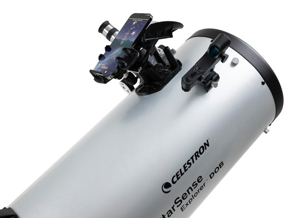

The adjustable dock held my reasonably large Android phone and case securely no matter where I pointed the telescope. Once your phone is locked in, you need to center it to the dock’s tilted mirror. (The tilt is set at the factory.) The StarSense app has easy-to-follow instructions on how to do this, but basically, you just turn the dock’s two adjustment screws until your camera is unobstructed.
The fine alignment begins when you point your telescope at an earthly object at least 100 yards (100 meters) away. It could be the top of a utility pole, a street sign, the top of a tree, etc. Center the object first in the red-dot finder, then in the scope’s eyepiece. Zoom in your phone’s view and slide it around with your finger until the same object is centered on the crosshairs. You may also need to use the dock’s adjustment screws until you center the target.

My verdict: The StarSense Explorer 10″ Dobsonian is a hit. Its two-piece construction makes it easy to set up or transport, it features a worthy aperture with high-quality optics, and the push-to system is easy to understand, align, and use.
