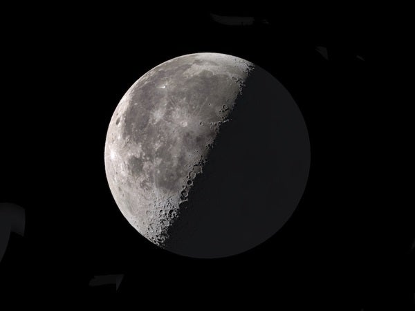

The Last Quarter Moon features the crater Copernicus and its rays, as well as stark shadows along the terminator. These features can be enhanced with colored filters.

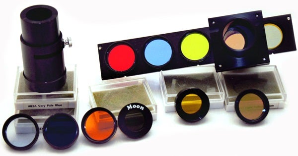

Colored filters useful for observing the Moon are sometimes sold as “Moon filters” or “planetary filters.” The housings for these filters are threaded in order to screw into the field end of eyepieces. You need to buy them in the correct size for your eyepiece barrel size (0.965, 1.25, or 2 inches), not by focal length. Be sure that the filters you purchase are made of optical quality glass and not plastic. Plastic filters may distort your view and scratch more easily than glass filters.
Pictured is a sample of eyepiece filters and a Lumicon 5-filter holder. The tube on the left is a Meade polarizer. The dark filter below the polarizer is a no. 47 violet filter. The filter labelled “Moon” is a neutral-density filter.

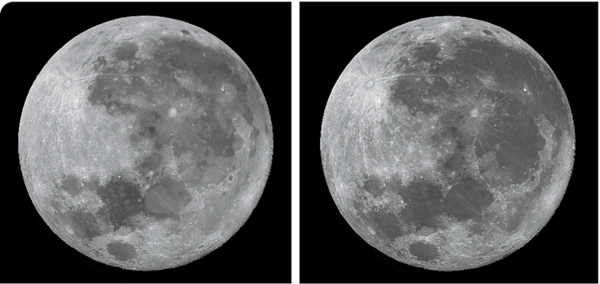

This series of images taken through RGB filters shows how colored filters can alter the contrast between different features on the Moon. A red filter (above left) reduces the contrast of lunar features but can be useful when imaging the Moon during the day. A green filter (above right) provides a slight boost in contrast.

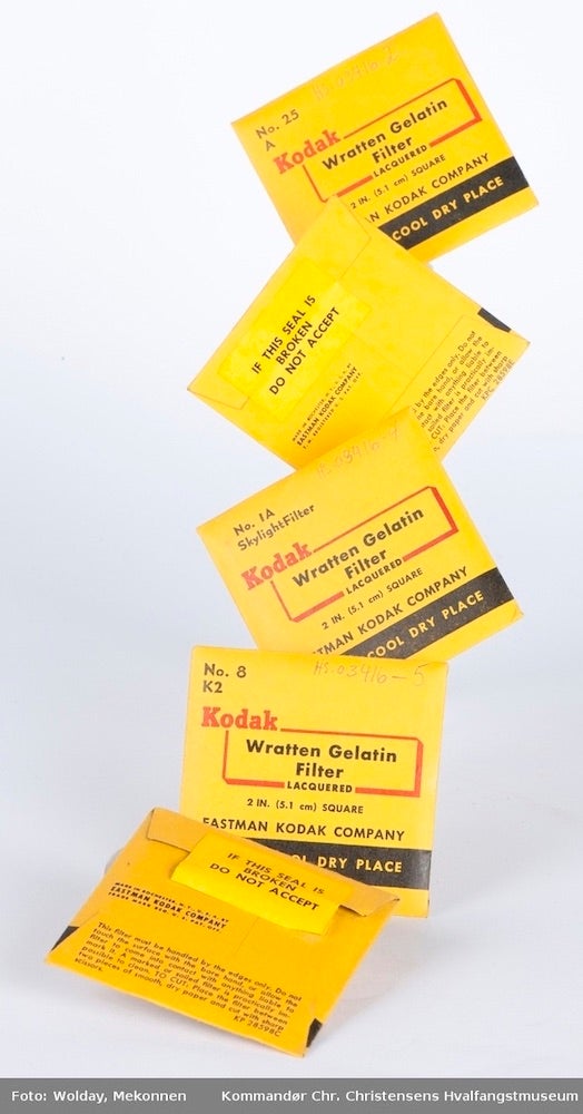

Kodak history
The numbering system generally used today for colored filters for eyepieces and cameras was developed in 1906 and 1907 by Charles Edward Kenneth Mees, while he was the chief scientist and managing director of the Wratten and Wainwright Company in Croydon, England. In 1912, George Eastman purchased the company and brought Mees to Eastman Kodak to establish a research and development laboratory. The identifying number assigned to these filters is still called the Wratten number, though some manufacturers use different color names for certain filter numbers.
Mees originally designed his filters for photographic work, but they are also very useful for visual lunar observing. Usually only a single filter is used at a time, but sometimes I will combine two filters of varying shades of yellows and blues to enhance the contrast between features. Stacking filters, however, also decreases the intensity of the light transmitted to your eye, thereby dimming your overall view. Experiment with colored filters and discover what combination works best for you during different lunar phases.

A blue filter (above left) can bring out different shades of gray due to variations in chemical composition, as well as emphasize bright crater rays. The false-color image (above right) combines the other three (see page 50) and shows the different features each channel highlights.

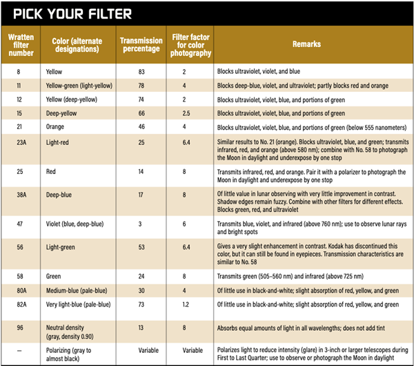

This reference table lists common filters used for lunar observations. The transmission percentage is how much light passes through it. The filter factor is the factor by which light is reduced. For each factor of 2, an increase in exposure by one stop is required. For instance, a filter factor of 8 requires an exposure increase of three stops.

The following is a list of some of the color eyepiece filters that are commonly sold for lunar observing:
No. 8 (yellow) gives sharp contrast between shadows and illuminated surfaces. Small features stand out, such as the individual peaks in Theophilus and shallow rilles that are not visible in a No. 21 (orange) filter.
No. 11 (yellow-green) has a slight improvement in contrast over the No. 8 (yellow). Either filter is good for observing at low solar illumination angles near the terminator. It also aids in locating lunar domes.
ASYLC0321_02
Under Kodak’s ownership, the Wratten system of gelatin-dye colored filters became a mainstay of photography and astronomical observing.
MEKONNEN WOLDAY / KOMMANDØR CHR. CHRISTENSENS HVALFANGSTMUSEUM. CC BY SA 2.0
No. 12 (yellow or deep-yellow) improves hue contrast and sharpens shadow edges. It’s great for observing small cone craters and maria wrinkle ridges that are lit by low solar illumination, and helps in locating domes. It’s also better than lighter yellow filters like No. 8 and No. 11 at bringing out fine details in rays, such as the Messier A comet tail rays in Mare Fecunditatis.
No. 15 (deep-yellow) is slightly darker with similar observing properties as No. 12, adding finer details to images.
No. 21 (orange) sharpens hue contrasts at shadow boundaries and reduces irradiation. This filter helps to make the crater rays more visible. The Moon turns a deep orange color, which takes some time to get used to. It also slightly darkens the Moon overall.
No. 25 (red) darkens the entire Moon and provides little visual improvement for lunar observing. Shadows are not as sharp as with green and yellow filters. The Moon’s terminator fades to black without a clearly defined edge to shadows. When used in combination with a polarizer, this filter enhances artistic black-and-white photographs of the Moon in daylight by dimming the blue sky. It is used mainly for viewing the planets.
No. 47 (violet) is called deep-blue by Kodak, but sold and advertised as violet, blue, or deep-blue for viewing Venus, Saturn’s ring structure, and clouds over the Martian poles. This filter darkens a lunar view, making it easier to observe the ray systems during the bright lunar phases. While this filter is too dark for use during the crescent phases, it is outstanding for the phases between First and Last quarters.
No. 58 (green) aides in observing thin shadows, such as crater wall terrace valleys, and very sharp shadow boundaries. It brings out subtleties in shading of mare surfaces. One can also pick out finer details with this filter than with no filter at all.
No. 80A (medium-blue) reduces glare and enhances contrast between areas of varying grayness.
No. 82A (very pale-blue) also helps to reduce chromatic aberration in low-quality refractors. The Moon appears gray in a No. 82A. However, shadow edges are not as crisp as with orange and yellow filters.

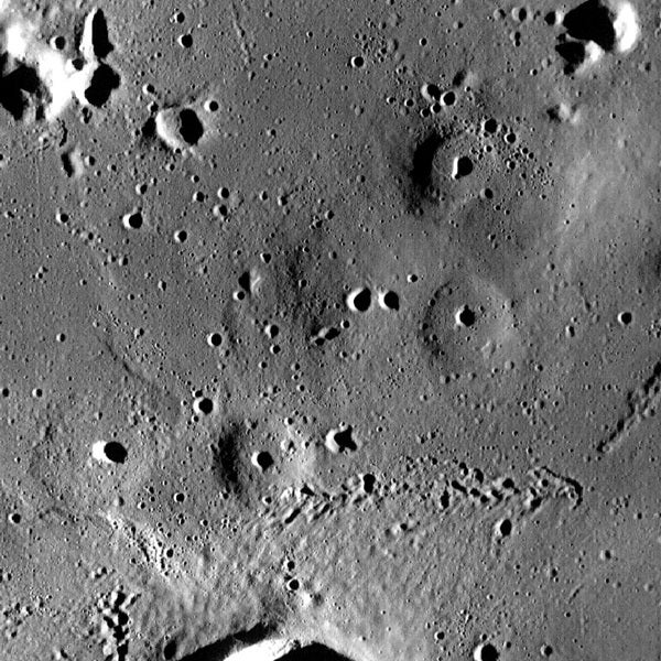

The Hortensius Domes, located near their eponymous crater in Mare Insularum and seen here in an image taken by LRO, are examples of lunar shield volcanoes. The relatively shallow slopes of lunar domes can make them tricky to spot, but a yellow filter can help by increasing the contrast of your view.
NASA/GSFC/ARIZONA STATE UNIVERSITY

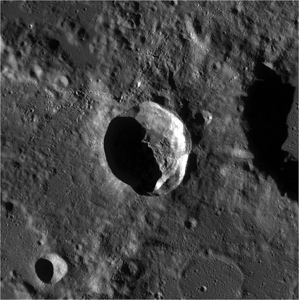

Thales Crater lies just west of the larger crater, Strabo. Thales H is visible in the southwest corner of this image taken by NASA’s Lunar Reconnaissance Orbiter (LRO).
True, this filter gives lunar features blue to purplish hues and reduces the overall contrast between gray features and shadows. Shadow edges are not as sharp as with the yellow and orange shades. But the small lit craters are even more noticeable because there is greater contrast between the features that appear white and those that become blue. The rays appear almost white and are therefore easier to observe against the blue and purple background.
In this filter, rays stand out like 3D images. Shortly after First Quarter, the rays emanating from the northeastern crater Thales become hard to detect in white light. But they are very noticeable through a violet filter. I find that many of the branches of the extensive Tycho ray system are easier to detect in violet than when observed at Full Moon through a polarizing filter. I have also noticed that, because a No. 47 filter allows only about 3 percent of the light to pass through it, I do not have to use a polarizing filter to reduce the brightness of a gibbous or Full Moon.

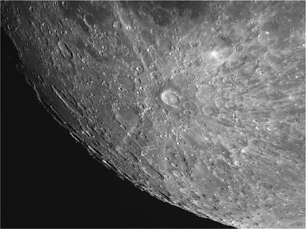

Tycho is a young impact crater in the southern lunar highlands and sports one of the Moon’s most prominent ray systems.
