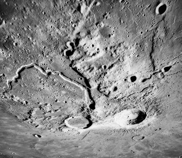

This image of the Aristarchus Plateau and its craters clearly shows the feature the author calls the Aristarchus X.

It was one such curious effect of sunlight reflecting off the walls of Schröter’s Valley and some neighboring cliffs that captured my attention. The light segments together created a striking white “X” (oriented roughly northwest-southeast) that teased my mind’s eye. I was using only a 3-inch refractor, yet I clearly detected the individual surface details constituting the X’s three components: The curved sunlit eastern rim of Schröter’s Valley forms one side of the X, while sunlight reflecting off two slightly angled cliff faces in deep ejecta blankets — one south of the crater Herodotus H, the other southwest of Aristarchus Z — creates the individual arms of the X’s other side. The pale glint off the lower cliff face near Aristarchus Z was the most subtle detail at the time of my viewing (5h UT), and defining it required moments of steady seeing — the utmost demand for any probing look at lunar or planetary features.
