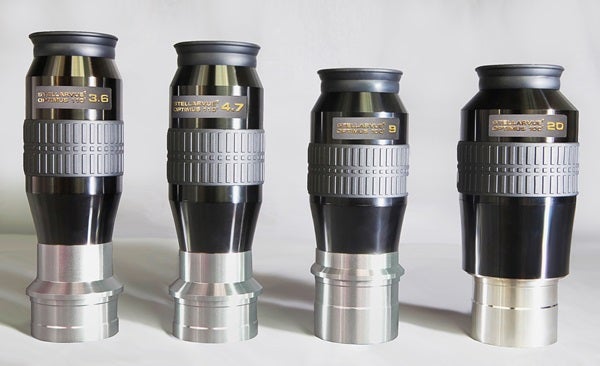

Stellarvue released its Optimus eyepiece line with four initial focal lengths. Expect at least a 13mm version this year.

Vic Maris, the founder of Stellarvue, wasn’t happy. Amateur astronomers had a lot of eyepiece choices, but he was convinced that he could do better. So, he set a goal to create eyepieces with apparent fields of view of 100° to 110° that would be ergonomic, lightweight, and offer high performance — all at a reasonable cost.
The current Stellarvue lineup features 9mm and 20mm models with 100° apparent fields of view and 3.6mm and 4.7mm versions that sport 110° fields. The company plans to introduce a 13mm 100° version in 2017. All eyepieces come with 1¼”-to-2″ adapters except the 20mm, which only fits a 2″ focuser.

All the eyepieces feature extreme broadband coatings on each glass surface to enhance light throughput and image contrast; special edge-blackening to minimize reflections and increase contrast; tight tolerances on polishing the glass to enhance performance; precision machining to the eyepiece’s body to make it easy to handle at night; high-grade rubber for the grips and eye cups to enhance longevity; sealed field and eye lenses to keep moisture out under normal use; and gold badges to designate their focal lengths.
Add all these up, and you get sharp contrasty views right to the edge of the field. Maris designed the eyepieces primarily for refractors, but they also work well with Newtonian reflectors if you add a coma corrector. That additional optic eliminates the defect called coma, which makes stars near the edge of the field of view resemble comets. Using such a device with a fast (short focal ratio) reflector will give pinpoint stars to the edge of the field of view.
