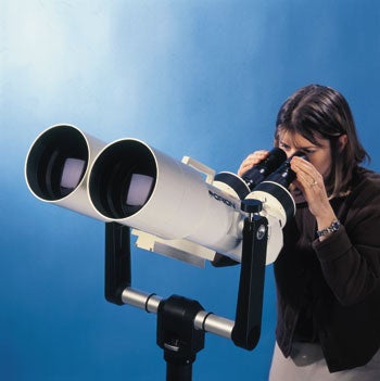

• Pick up the binoculars and shake them gently. Giant binoculars are heavy, so do this carefully. Then move the focusing mechanisms several times. Then move the barrels (or the eyepiece holders) together, then apart. What you’re testing is quality of workmanship. If you hear loose parts or if there’s any play when the binoculars are twisted or moved, don’t buy them.
• Can you handle the binoculars? Consider their weight, size, and center of mass. As mentioned above, you won’t be hand-holding giant binoculars, but you will be transporting them and lifting them onto a tripod or other mount. Was a handle incorporated into their design? Try to imagine what moving them will feel like at the end of a long observing session.

For the steadiest images possible through any binoculars, nothing beats mounting them to a tripod or custom binocular mount. Smaller, well-mounted binoculars with less magnification will, after a few short minutes of continuous use, surpass hand-held binoculars of larger aperture and power. And because you can’t hold giant binoculars, some type of mount is essential.
The simplest binocular mount is an “L” bracket. This attaches to a mounting hole on the center post of the binoculars. The size of this mounting hole usually is standardized to the same size found on the base of every 35mm camera. The other end of the “L” attaches to a camera tripod. This setup is generally an adequate one if the objects you’re observing are not too high in the sky or if the size and weight of the binoculars do not overwhelm the tripod. For objects near the zenith, tripod mounted binoculars are uncomfortable — and in some cases impossible — to use.
The other option, and the one most generally chosen for giant binoculars, is to use a custom-made binocular mount. All manufacturers of giant binoculars either provide a custom mount or recommend one made by another manufacturer. Plans for binocular mounts that you can build also are available. If you are mechanically inclined and have a well-stocked tool shop, you can build your own binocular mount.
If you choose a mount for your giant binoculars not provided by the manufacturer, be sure to pick one that’s quite a bit sturdier than you think you require. In addition to providing a bit of a safety margin (with regard to the mount’s weight-handling ability), such a choice will allow you to upgrade your binoculars in the future.
Sturdiness in a binocular mount, as I define it, means that a few seconds after you have located an object in the field of view the image settles down and shows no vibration unless there is a strong wind blowing. If the image is not stable, your binocular mount may be at fault. Alternately, the fault could lie with the second piece of equipment needed — the tripod.
The other necessity for giant binoculars is the tripod for the mount. Most camera tripods are inadequate when it comes to supporting giant binoculars. They’re simply not robust enough to handle the weight of the binoculars plus the weight of the mount. This deficiency becomes even more apparent when the legs of the tripod are extended. After that’s done, you’ll pretty much know immediately if your tripod is right for this task. Many owners of giant binoculars opt for large, heavy tripods with tubular steel legs — the type sold by many telescope manufacturers.
Finally, a tripod can fail in more ways than by being flimsy. It may be that your sturdy tripod, even at full extension, is not high enough to allow you to stand under your binoculars and view objects near the zenith. Most observers who use giant binoculars choose to sit while observing, but that position may not suit you. Remember, however, that the higher your mount/tripod combination is, the sturdier it must be.
