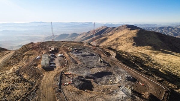

The Extremely Large Telescope, shown in an artist rendering on location in Chile, will be one of a new crop of telescopes that could change astronomy forever.
ESO/L. Calçada

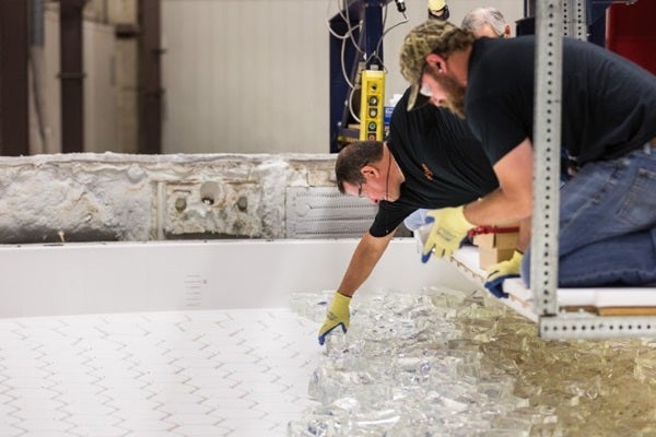

Each of the Giant Magellan Telescope’s seven mirror segments must be carefully crafted to exact specifications, to ensure accurate observations. Here, staff at the Richard F. Caris Mirror Lab place a fresh layer of glass into a mirror mold.
Giant Magellan Telescope – GMTO Corporation
In the first, they cast a single, monolithic mirror. University of Arizona astronomer Roger Angel pioneered this method after conducting a backyard experiment around 1980. Technicians start the process by loading chunks of glass into a furnace mold. They then raise the furnace’s temperature to 2,100 degrees Fahrenheit, and spin the entire assembly at a rate of five revolutions per minute. Once the chunks melt to the consistency of thick honey, the glass flows into a bowl-like or parabolic shape — perfect for focusing incoming starlight — as a result of the rotation. The mirrors are no more than 1 inch thick and have a honeycomb structure to keep their weight down. Technicians then grind and polish the mirror’s surface to the exact shape needed.
Arizona’s Richard F. Caris Mirror Lab has cast mirrors for many of the world’s largest telescopes, including the 6.5-meter MMT Observatory and the twin 8.4-meter monsters of the Large Binocular Telescope, both in Arizona.

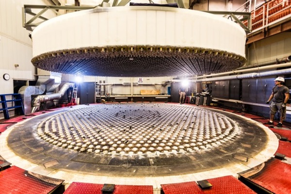

A crane lifts one mirror segment from the furnace floor at the Richard F. Caris Mirror Lab.

The other two giant telescopes of the next decade have gone a different route. Both the Extremely Large Telescope (ELT) and the Thirty Meter Telescope (TMT) will consist of hundreds of hexagonal segments joined together to create mammoth collecting areas.
Europe’s ELT boasts 798 segments in its primary mirror — each measuring 55 inches across — giving the telescope’s primary mirror an aperture of 39 meters. The German optical company Schott cast the first of these segments in early 2018, and has been churning them out since. Groundbreaking for the mammoth telescope took place in June 2014 on Cerro Armazones, a 9,993-foot mountain in Chile. If all goes according to plan, the ELT should see first light in 2025, around the same time as the GMT.
