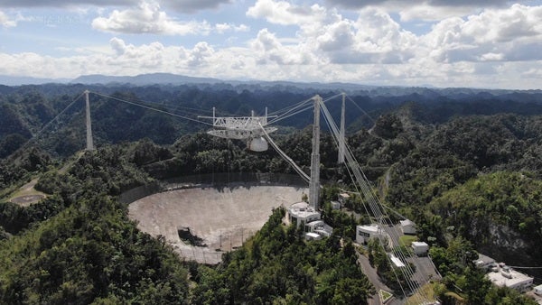

Both cables that have failed were anchored to the facility’s southeast observing tower (at left). This image, taken the day after the main cable break, shows additional damage to the reflector dish, enlarging the gash left by the previous auxiliary cable failure.

Due to two cable failures in the past three months, outside engineering firms have concluded the telescope cannot be repaired — at least, not without risking the total collapse of the 900-ton receiving platform onto the dish below, the lives of workers, and further damage to existing buildings onsite.
As a result, the U.S. National Science Foundation (NSF), which owns the facility, has decided to decommission Arecibo, the organization announced today.
Engineers are now “working against the clock” to develop a plan for a controlled decommissioning, said Ralph Gaume, the NSF’s astronomy division director, in a media briefing this morning. That could come in the form of a demolition using explosives, according to a report from one of the three engineering firms that have been working to try to save the facility after the failure of an auxiliary cable on August 10.
That cable slipped out of its socket at one of the three support towers that surround the observatory, tearing a 100-foot (35 meter) gash in the dish below. In the aftermath, engineering efforts focused on ensuring that the rest of the auxiliary cables did not suffer similar failures, as some had started to slip more than half an inch.
But then on November 6, one of the main cables attached to that same support tower snapped.
The main cable had seen some of its strands break, but engineers didn’t think a full failure was an immediate threat, as the remaining load was still within its design capacity. “I don’t think anyone understood that, clearly, the cable had deteriorated much below just those broken wires,” said Ashley Zauderer, NSF’s Arecibo program officer.
Engineers concluded that the main cable failure removed the safety margin necessary to conduct repairs and stabilization, which had been set to begin just days later. Another cable failure at the same support tower would push the cables beyond their design capacity, likely leading to a full collapse.
The only path forward would have been to demonstrate that the remaining cables could handle an increased load by testing them. But such tests would require placing workers at risk, as well as increase the chances of a total collapse, reported the engineering firm Thornton Tomasetti.

NSF officials said that the decision to demolish the radio telescope was necessary to save the rest of the observatory’s infrastructure, including a lidar facility and the visitor and education center, which serves as a hub for outreach.
One of the three firms working on Arecibo believed that repairs would be possible if commenced immediately — and if the observatory was willing to risk a collapse. But that would endanger the visitor’s center and other buildings that sit below one of the support towers, said Gaume, leaving demolition as the only safe option.
