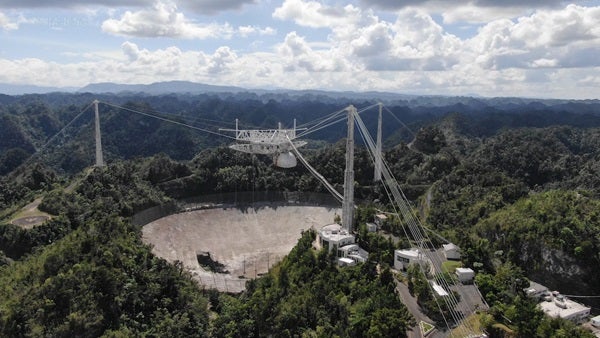

Arecibo damage
Both cables that have failed were anchored to the facility’s southeast observing tower (at left). This image, taken the day after the main cable break, shows additional damage to the reflector dish, enlarging the gash left by the previous auxiliary cable failure.
University of Central Florida/Arecibo Observatory

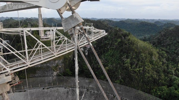

Frayed Arecibo cable
Taken the morning after the main cable failed, this image shows the remnants of the cable dangling from its socket atop the southeast support tower.
