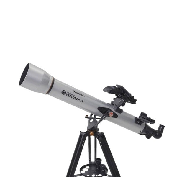

The line of StarSense Explorer telescopes has four models. In order of increasing aperture, there are two refractors — the 3.1-inch (80 mm) f/11 LT 80AZ and 4-inch (102 mm) f/6.5 DX 102AZ — and two reflectors — the 4.5-inch (114 mm) f/9 LT 114AZ and 5.1-inch (130 mm) f/5 DX 130AZ. The LT models share a common altitude-azimuth mount, with a cellphone cradle attached to the telescope tube. Each DX scope rides on its mount sidesaddle, with your smartphone sitting directly across the altitude axis from the telescope.

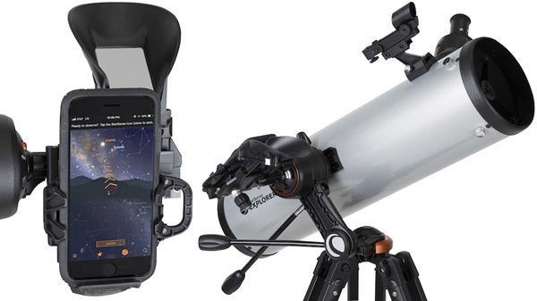

The StarSense Explorer scopes are “push-to” mounts that the user moves under the direction of the Celestron StarSense app running on a smartphone. Snap your phone into the secure dock, complete the on-screen instructions to align it, and you’re ready to go. Credit: Celestron

The telescope tube attached to the mount easily via a dovetail plate that locks it securely into the mating side-mounted base. The spring-loaded smartphone dock locked into the altitude axis’ mating bayonet with a discernible click.
The dock held my iPhone securely no matter which direction the mount was aimed, from horizon to zenith. That’s important because the phone’s aim is critical. The dock’s secure locking system prevents it from shifting during use, but the phone’s aim toward the dock’s tilted mirror needs to be calibrated after initial set-up. The StarSense app offers easy-to-follow instructions to do this quickly by turning the dock’s fine-thread adjustment screws.

With the scope and phone aligned, I was ready to explore with the Explorer. The app shows the sky, complete with constellation names and line drawings. Along the bottom of the screen are several options. Pressing the pulsating star icon brings up a list of suggested targets, divided into “Tonight’s Suggested Objects” and “Tonight’s Challenge Objects.” Each gives a little capsule summary, including whether it is “City Viewable” or “Dark Sky Viewable.” The list is limited to the Messier catalog and other relatively bright deep-sky objects, as well as prominent stars, double and binary star systems, asterisms, and, of course, the Moon and planets. The choices are designed to match realistic expectations for the scope’s aperture.
I put aiming accuracy to the test right away by swinging from the Moon, far to the south at the time, toward Albireo, the beautiful bicolored double star halfway across the sky in Cygnus. After I selected it from “Tonight’s Suggested Objects,” directional arrows appeared, showing the way. Grabbing the mirror-end of the tube, I pivoted the scope’s aim. Sure enough, after the bull’s-eye on the screen changed from red to green, signaling acquisition, I peered into the 25mm eyepiece and saw Albireo perfectly centered. I was impressed. Pausing for a moment, I selected the “Celestron Audio” feature and listened to a short description of what I had in view. The screen also displayed information about Albireo, including hints on how to best observe it.

Other scopes in the StarSense Explorer line include another reflector and two refractors. Shown here is the 3.1-inch (80 mm) f/11 LT 80AZ refracting model. Credit: Celestron
