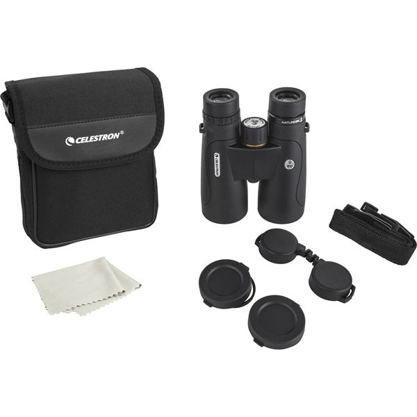

Everything shown here is included with Celestron’s Nature DX ED 10×50 Binoculars.

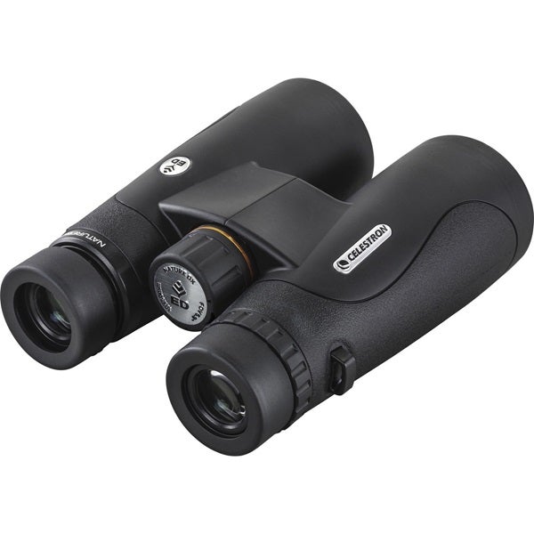

Two of the biggest ergonomic benefits of roof-prism binoculars are their compact size, and their lighter weight compared to similar Porro-prism models. For instance, my own 10×50 Porro-prism binoculars weigh 32 ounces (907 grams), while the DX ED 10x50s are only 28.4 ounces (806 g). Part of the credit goes to the choice of materials. Celestron made the ED’s housings out of polycarbonate, which is known for its strength, light weight, and low cost.
The barrels have a rubber finish that makes holding them sure and comfortable. The flat black color prevents reflections from nearby light sources when raising the binoculars to your eyes. Two textured, slightly depressed areas guide your hands to the proper position.
The Nature DX ED comes with lens caps tethered to the barrel so they can’t be lost. You also can tether the dual eyepiece cap to the neck strap.
To work properly, the span between the eyepieces — called the interpupillary distance — must match the distance between the observer’s eyes. For the average adult, that’s between 2.3 and 2.8 inches (58 and 71 mm). I measured the adjustment range of the Nature DX ED 10x50s to be between 2.2 and 2.9 inches (56 and 74 mm).
Rubberized twist-up eye cups with click stops help make centering each eye easier. The eye cups extend 0.35 inch (8.9 mm) when twisted all the way out. I found them great for observing, and the generous 17.8 mm of eye relief also added to viewing comfort. This is important if you must wear eyeglasses to correct for astigmatism. I normally remove my glasses, but I found seeing the full 5.9° field of view was easy even with them on.
ASYER0220_02

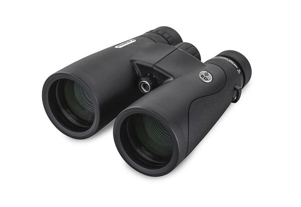

Celestron’s Nature DX ED 10×50 Binoculars offer great low-light performance.
The focusing knob works smoothly with just the right amount of resistance to prevent it from being turned by mistake. The fine-thread mechanism takes almost two full turns of the knob to bring the focus from one extreme to the other. As with most binoculars, the right eyepiece can be focused +/- 3 diopters for people whose eyes aren’t identical.
Although binoculars are great for grab-and-go viewing, I prefer securing mine to a tripod when using a star chart to find unfamiliar targets. The Nature DX EDs include a built-in tripod mount in the front of the central hinge between the barrels. The barrels are quite close to one another, however, so some L-shaped tripod brackets may not fit. Celestron’s model No. 93524 binocular tripod adapter L-bracket does work.
