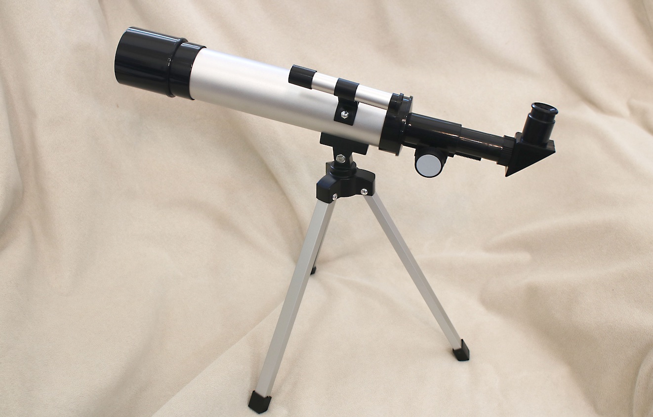

Inside the box, I found a well-packed tube assembly, a tabletop tripod, instructions, and a plastic bag of parts that included the finder scope and two eyepieces enclosed in protective plastic capsules. Both eyepieces have nonstandard, 0.93-inch (23.6 millimeters) diameters and are made of plastic. The eyepieces are ancient Huygenian designs with inherent narrow fields and chromatic aberration, an optical problem where red light and blue light don’t focus at the same place.
Assembly was quick and straightforward, but it immediately revealed a fatal flaw. Even a novice stargazer (and certainly a telescope designer) knows that a telescope mount needs to move in two perpendicular directions to aim at celestial objects. Simple telescope mountings move the tube up and down (in altitude) and back and forth parallel to the horizon (in azimuth). This scope has only the altitude motion!
The tube attaches to the tripod via a plastic pivot hinge. A metal bolt passes through holes in the hinge and a hex nut secures the tube to the tripod. The bolt and nut provide adjustable friction for the altitude motion. Unfortunately, the only way to adjust the friction is with an included metal wrench. It would have been better to use a wing nut or a threaded clamping knob.
Cumbersome as the altitude adjustment is, the lack of azimuth adjustment is a deal-killer. The only way to aim the telescope in azimuth is to skitter the whole tripod around on the surface it sits on. This flaw makes the telescope almost impossible to aim at an object, much less track it. This also restricts the altitude range when the tube is attached in one of two possible configurations. One position places the tube directly over one of the tripod legs, which limits tilt — the tube can only reach about 45° in altitude before it hits the leg. Should you attach the tube 180° around to clear the leg, you’ll find that you can’t use the cellphone attachment. If you do so, the mount balance shifts so much that the tripod topples over!

Another huge flaw is the finder scope. A finder is supposed to have a wide field of view (between 5° and 8°) to help aim the main scope. Finders also usually have crosshairs in them to let the observer center on the target object. This finder has no crosshairs. Furthermore, its field of view is only about 2°, and its 13 mm objective (good finders have 50 mm objectives) gathers very little light. Worst of all, this finder has no way to adjust its alignment with the main telescope. That makes it all but useless.

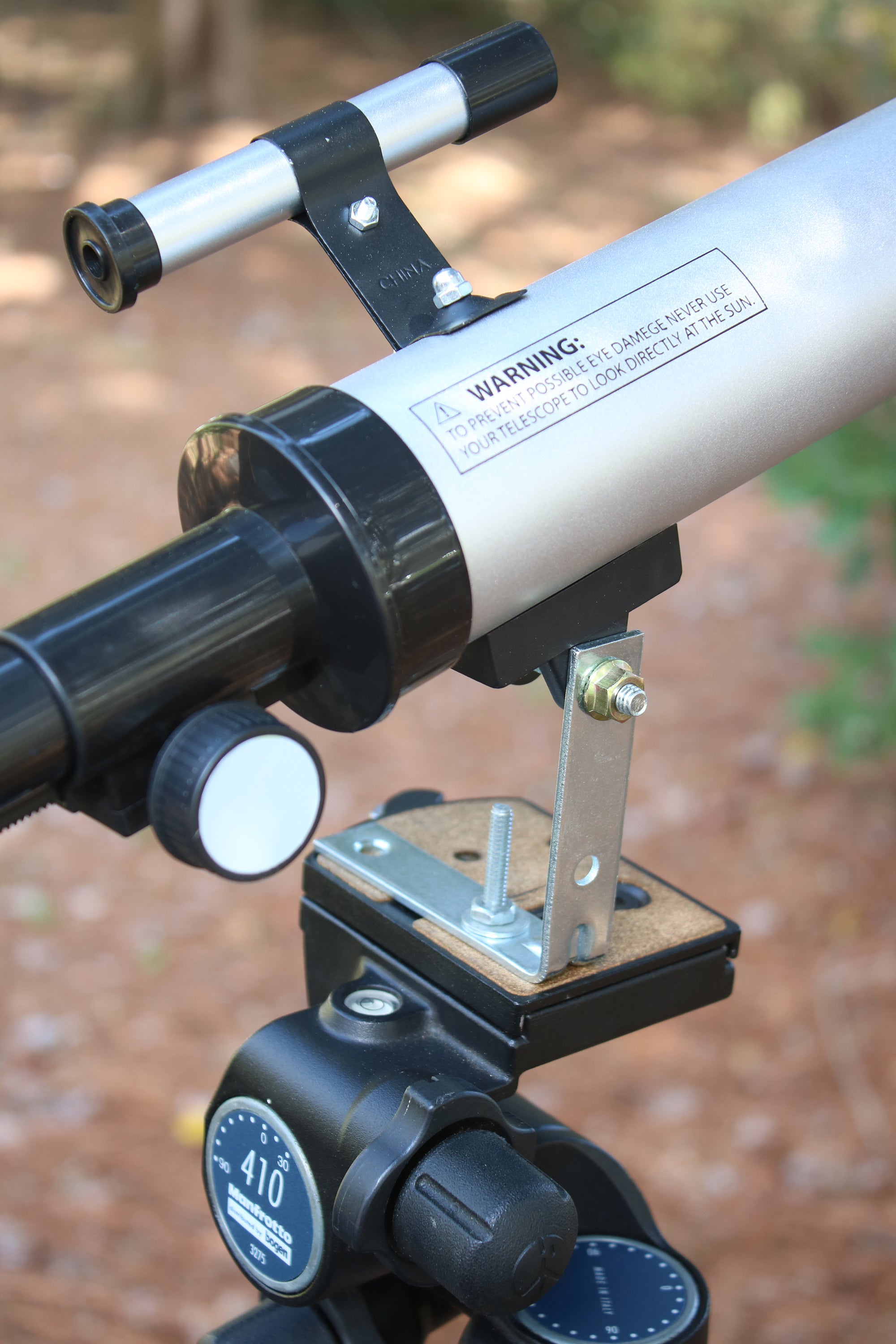

Without a usable finder or a proper mount, testing the telescope optics proved a real challenge. I wound up making a bracket to attach just the tube to a camera tripod that had both altitude and azimuth controls so I could aim it. Sighting along the main tube and using the lowest-power (20x) eyepiece, I was eventually able to view a few bright celestial objects.
