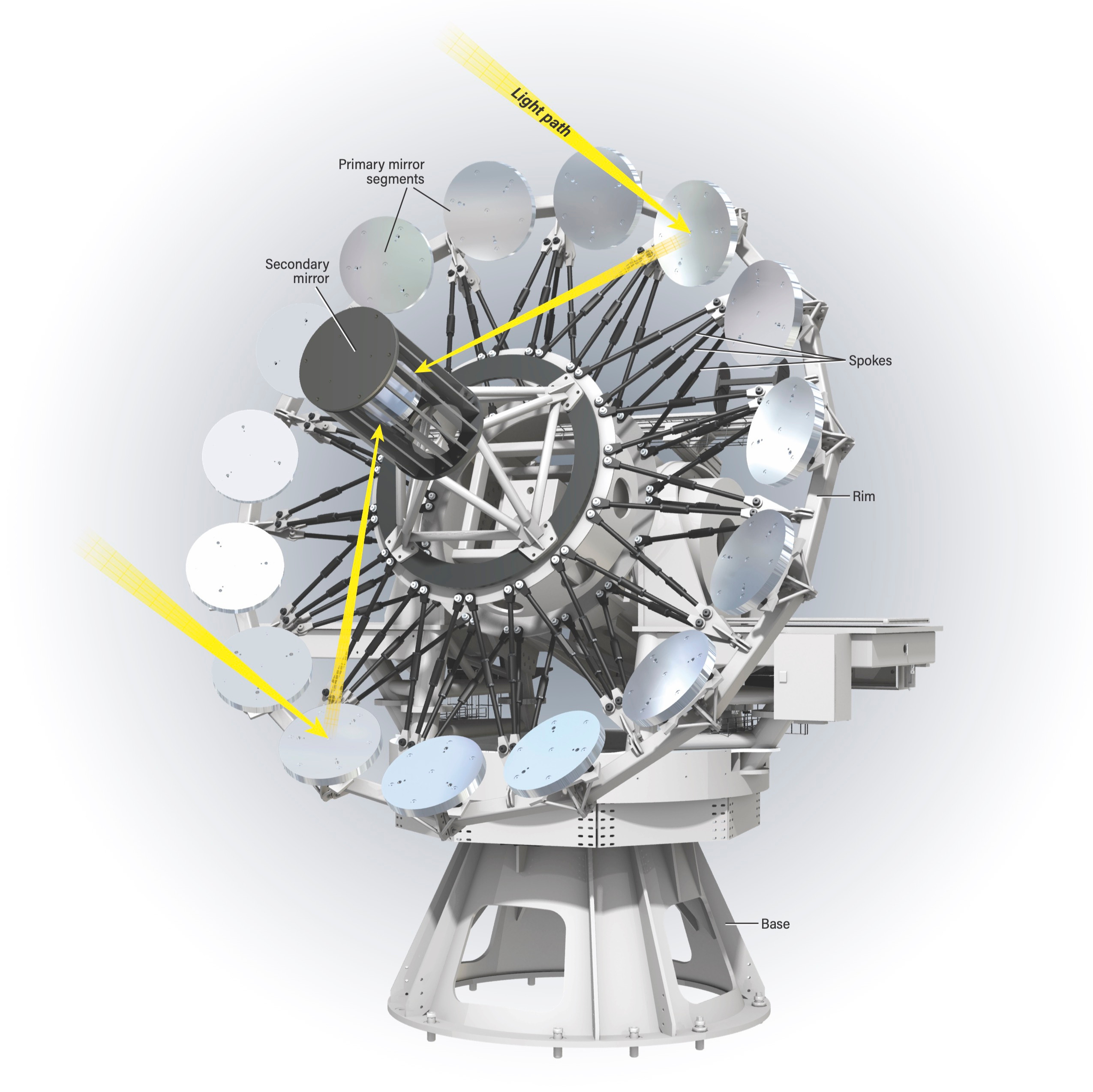

The ExoLife Finder (ELF) looks like no telescope ever built. A spectacular crown of 15 five-meter mirrors perches atop a sprawling metal lattice, resembling petals on a 10-story-tall mechanical flower — more sculpture than observatory. It is a fundamentally new type of telescope, one that its designers say could discover life on Earth-like planets beyond our solar system.
The radical design is the brainchild of astrophysicist Jeff Kuhn of the University of Hawai‘i. For now, it exists only in renderings. To build it, Kuhn and the team he’s assembled must first develop and perfect techniques and technologies never before used in astronomy.
That ring of mirrors, working in sync, would use a cutting-edge technique — the equivalent of stellar noise canceling — to block out the glare of a host star so it can capture images of orbiting worlds. If it works, it could monitor planets, create surface maps, and possibly even detect heat given off by life-forms or their technology.

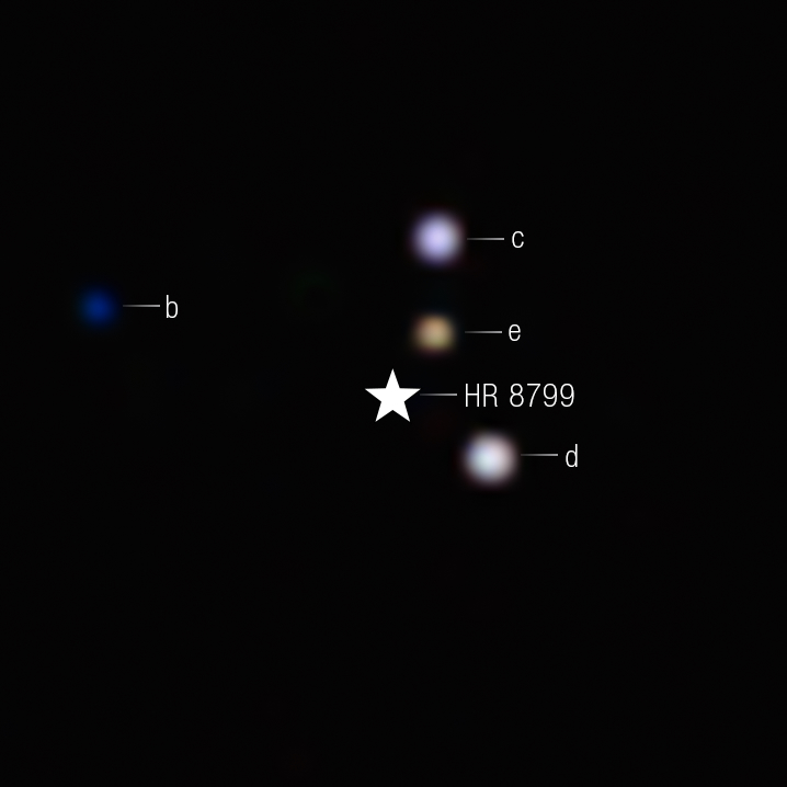

Direct imaging of exoplanets is possible today using a coronagraph to physically block out the host star’s light. This technique allows us to see large (bright) Jupiter-sized gas giant planets far from their stars; smaller, terrestrial and Earth-like planets remain invisible with current technology. This photo shows HR 8799 b, c, d, and e, as imaged in infrared light by JWST. The host star’s location is marked with the cartoon star symbol. Credit: NASA, ESA, CSA, STScI, Laurent Pueyo (STScI), William Balmer (JHU), Marshall Perrin (STScI)
Think of a performer on stage. They can’t see the audience through the spotlights aimed at them. To mitigate this, they might block the glare with a hand in front of their face. Astronomers now routinely do this on ground- and space-based telescopes using an instrument called a coronagraph, which creates an artificial eclipse by placing a physical mask in front of the undesirable light source.

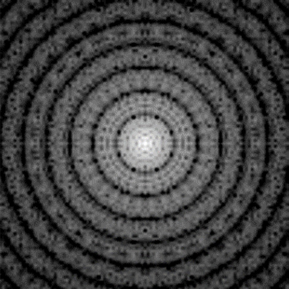

A star’s image in a telescope is not a perfect dot, but a slightly blurred spot with a structure that astronomers call the point spread function. The shape, number, and orientation of a telescope’s mirrors and other structures all combine to produce a characteristic diffraction pattern of alternating bright and dark areas in that point spread function. Think of stars in Hubble images, with their sharp X-shaped set of spikes, or the distinctive eight-pointed spikes in JWST photos. These are diffraction patterns. They can be a nuisance — but if your telescope is cleverly designed, they can become a resource.

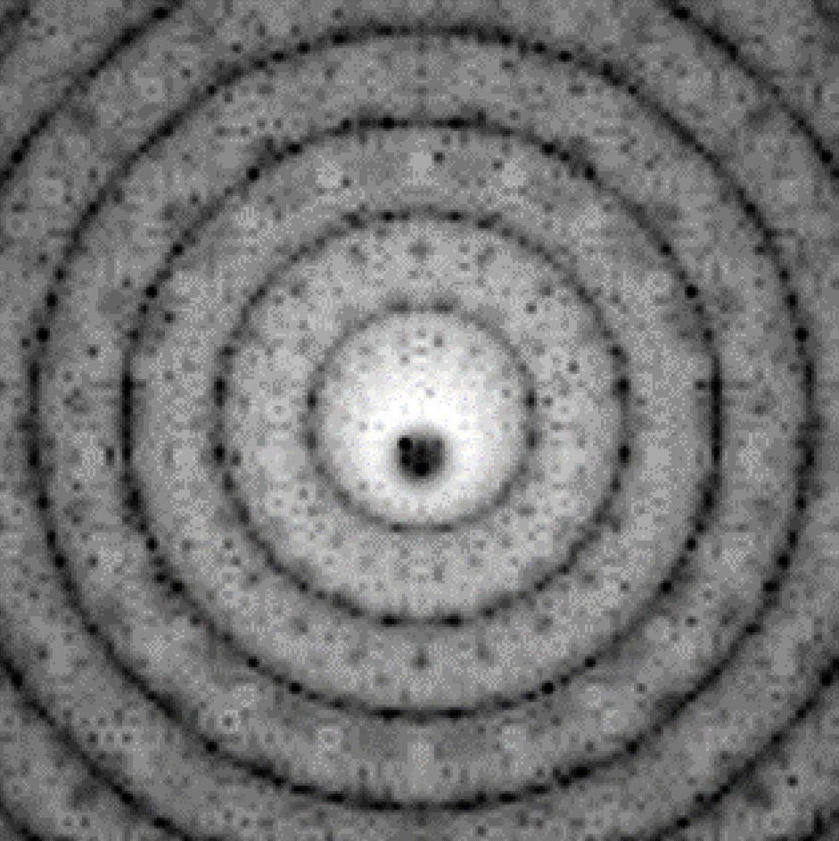

“We can now create and customize the telescope’s diffraction pattern, so the telescope itself becomes a coronagraph,” Kuhn says. Destructive interference creates a “hole” near the star’s position, allowing the fainter light of the planet to shine through.
ELF is designed so that when its beams are combined, they can form a characteristic pattern of self-interference. “The trick is that, if instead of putting all these mirrors exactly in phase [so all the troughs and peaks of the light waves line up] we shift them a little, adding some relative phase between them, we can control things so that destructive interference is generated at a specific point in the image,” explains Auxiliadora Padrón Brito, a postdoctoral researcher at the Instituto de Astrofísica de Canarias (IAC).
A simulation of ELF’s point spread function — the way an image of a bright star appears when the light from all its mirrors is combined. The mirrors create an image with a lobulated structure that looks almost like a sunflower. Credit:
Kuhn et al., Light: Advanced Manufacturing (2025), DOI 10.37188/lam.2025.033 (CC BY 4.0)
The point spread function when all the mirrors are co-phased, or tilted relative to each other such that a dark region of destructive interference occurs (just below center). By placing the star (and its planets) in this “hole” where the starlight is absent, the planet’s faint light can be directly observed. Credit:

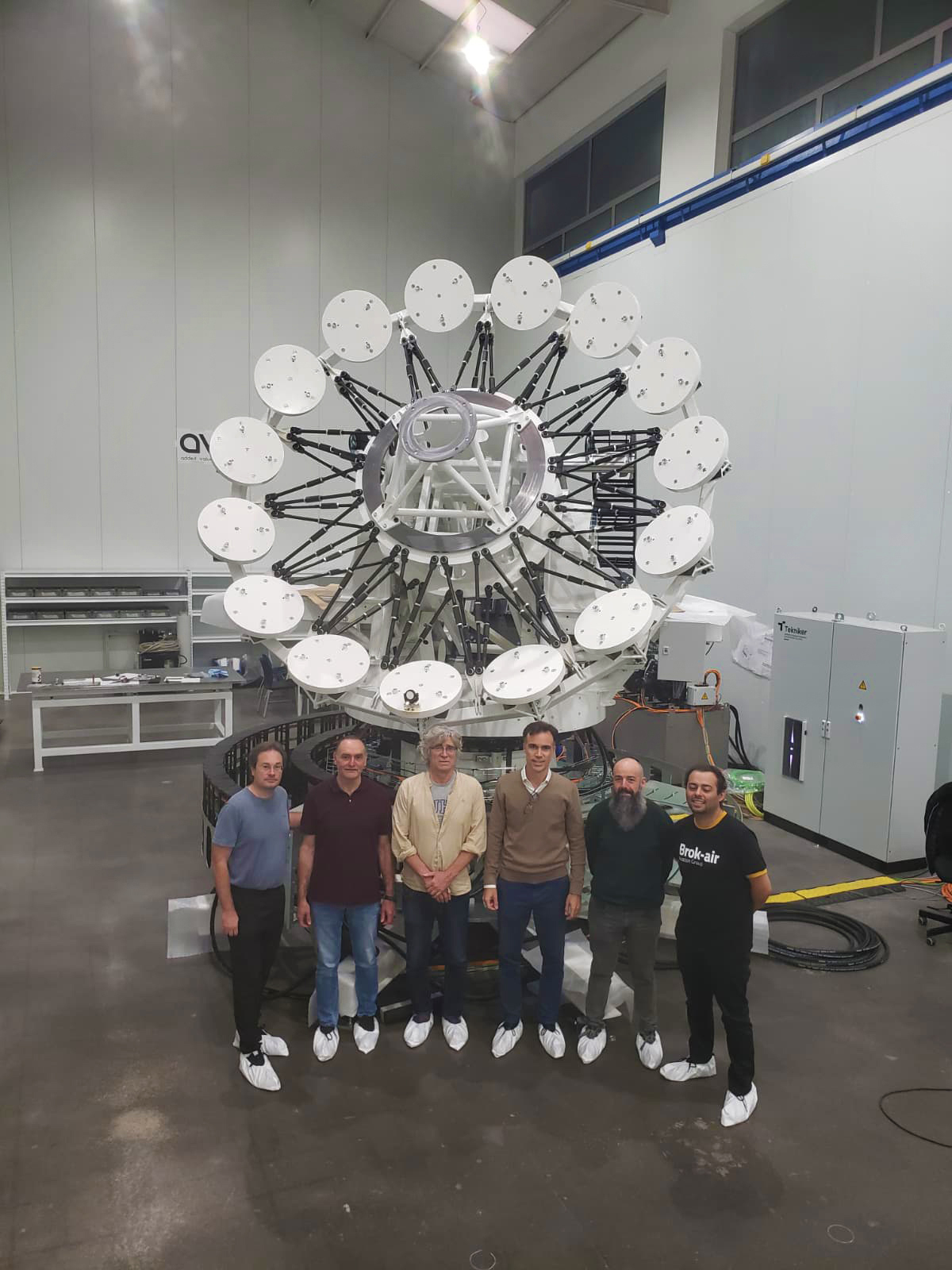

To solve it, Kuhn has assembled a team of around 20 scientists and engineers at the Laboratory for Innovation in Opto-Mechanics (LIOM) in San Cristóbal de La Laguna, Tenerife, in the Canary Islands, that includes top-tier experts as well as young talent. Electronics engineer Diego Tamayo Guzmán and neural-networks specialist Natalia Arteaga Marrero are working on a way to control ELF’s mirrors. The 15 primary and 15 secondary mirrors have more than 500 possible degrees of freedom, or independent ways the mirrors can move.
To achieve a coherent image, the primary mirrors must be precisely tuned together “to within tens of nanometers,” says Arteaga Marrero. That’s smaller than the size of a virus. This tuning must happen quickly, on timescales of about 10 milliseconds.
Several team members pose in front of the completed mechanical structure for the SELF telescope after it successfully passed structural testing in early November 2025. From left to right: Nicolas Lodieu, SELF project scientist; Ricardo Diego Garamendi, Added Value Industrial Engineering Solutions (AVS) president; Jeff Kuhn, LIOM project chair; Sergio Salta, AVS Earth Observation Project management; Jose Antonio González Olivera, TEKNIKER Automation and Control Unit researcher; Diego Tamayo Guzmán, control engineer. Credit: LIOM and the Instituto de Astrofísica de Canarias (IAC)

The team is also looking to lighten the telescope structure itself to reduce costs and make the project feasible. One idea comes from a concept developed by American architect Buckminster Fuller in the 1950s known as tensegrity, a combination of the words tension and integrity.
Engineers are concerned with two types of stress. Normal stress comes from force that acts perpendicular to a surface. That’s exactly what you want when you hammer a nail into a board, striking along the axis of the nail so the force is perpendicular to the wood. When you miss and the nail bends (and maybe your finger gets smashed), it’s because the blow had a sideways (tangential) component, parallel to the surface. That tangential component produces shear stress, which makes the nail bend instead of sliding in cleanly.
Tensegrity minimizes shear stress by creating structures where the elements carry only normal loads, using precisely tensioned cables that force the pieces to hold each other in place. “We need to create a lightweight structure because we have to build something very large and precise, but affordable. And tensegrity seems one of the best ways to achieve that,” Kuhn says.
Combining precision optics with a network of cables under tension demands a level of calculation and design without precedent. The team is using machine-learning tools to help with the structure’s design. The network of cables and struts must also withstand environmental factors like wind, temperature changes, and seismic vibrations. Sensors and actuators will provide feedback, continuously adjusting tension to maintain the correct destructive interference to block the target star’s light.
