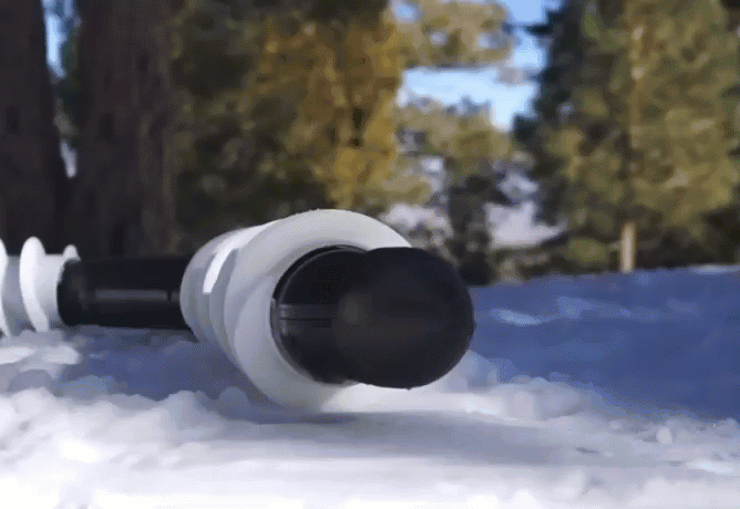

A new snake-like robot being developed at NASA’s Jet Propulsion Laboratory (JPL) could someday help scientists do just that.
The 14-foot-long robot, named Exobiology Extant Life Surveyor (EELS), is currently in its third year of development and has a goal to autonomously navigate icy surfaces and explore areas that are otherwise inaccessible to conventional, four-wheeled robots. The serpent-shaped robot has a “head” infused with cameras and sensors, including a laser-based system that creates maps of its environment — the same way autonomous cars can map out the world. The robot’s “body” is comprised of individual modules linked together that can host science instruments. It also has spiral connectors throughout the body to propel the robot forward.
EELS can get to places some rovers can’t
This technology, described in a paper published in Science Robotics, allows EELS to traverse on flat ground, wrap itself around an object to inch ahead, and tunnel through a narrow passage, thus changing its shape to get in and out of spaces where a conventional rover will be too big to fit.
