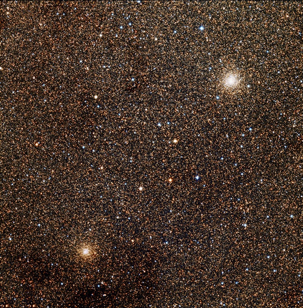

Globular clusters NGC 6522 and NGC 6528 (left image) float amid the seemingly uncountable stars toward the center of our galaxy. Here, we look through Baade’s Window and see more stars than normal because of a break in the dust clouds that pervade the area. In addition, two globular clusters, each representing a hyperbole of a stellar swarm, scream that stars and their sheer number are part of the story here.
What did Johannes Kepler, Heinrich Olbers, and even Edgar Allan Poe see in their mind’s eye when they considered an infinite universe of stars while trying to reckon with the darkness of the night sky? This stellar field could represent something close. And I wanted the picture to communicate the story of Olbers’ paradox, which asks why, if the universe is infinite, we don’t see stars covering the sky.
NGC 6522 (upper right) and NGC 6528 (lower left)
NGC 6522 (upper right), NGC 6528 (lower left), and the multitude of stars within this region inspired the author to create a scene illustrating Olbers’ paradox.
All images: Adam Block/Mount Lemmon Skycenter/University of Arizona
When processing the image, I applied a few more iterations to the deconvolution than I might otherwise do for a large diffuse object. I also masked this sharpened image less when blending it with the original. (See my January 2015 column about masks and deconvolution online at www.Astronomy.com/Block.) I then used an unsharp mask on the entire image at a value that was less than the average profile of stars. This acts as an edge enhancement and prevents stars from looking “connected” and indistinct.
I also brightened the image aggressively. Normally, stars cause visual confusion (see June 2015’s column about getting the maximum out of the minimum filter), but in this case we want the stars emphasized. Finally, when applying the mask for noise reduction, I was careful that “Smoothing” only act on the darkest pixels so the faintest stars didn’t dim.
