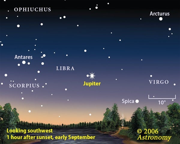

Jupiter floats low in the southwest as twilight ends in early September. The giant planet is the brightest evening object except for the Moon. Saturn appears in the east before dawn and gets higher as the month progresses.
Chances are, Jupiter and Saturn will appear blurry when you view them at magnifications above 150x. The problem — they lie low in the sky, so we view them through lots of Earth’s atmosphere. Turbulence washes away detail, so be patient, and wait for steady moments.

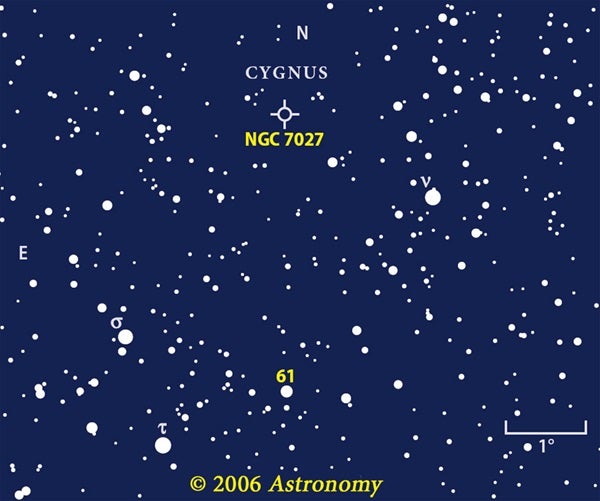

With your naked eyes, you can see 61 Cygni in the upper left of Cygnus the Swan. A nice surprise awaits you when you point a telescope at 61 Cygni. Not only does it split into a pair of stars, the two components glow with a light-orange hue. From their color and brightness, astronomers deduce these stars are smaller and fainter than the Sun.
The pair takes 653 years to complete one orbit. The stars currently appear 30″ apart, a bit less than Jupiter’s apparent size. But at a distance of 11.4 light-years, this separation translates into a gap of about 100 astronomical units, or 2.5 times the Sun-Pluto distance.
In 1792 (9 years before he discovered the first asteroid, Ceres), Italian astronomer Giuseppe Piazzi noted 61 Cygni’s rapid motion. It moves 5″ per year. So, in just 6 years, the pair will move an amount equal to the current space between them. Use as much magnification as the atmosphere and your telescope will allow, and make a sketch of the pair along with nearby stars. Put your finished drawing where you can’t lose it. Then, return to the field in 5 or 6 years to see if you notice a change.

Eastern Cygnus
Eastern Cygnus offers observers several worthwhile targets, including the rapidly moving doublestar 51 Cygni and the bright planetary nebula NGC 7027.

The most prominent point of light in the evening sky this month is Jupiter. The giant planet gleams at magnitude –1.8 low in the southwest after sunset. In early September, Jupiter appears 15° high by the time twilight ends. It sinks lower as the month progresses. This means the best views will come in late twilight. Later in the evening, Jupiter’s light passes through thicker layers of Earth’s turbulent atmosphere, which smears our view of fine details in Jupiter’s own atmosphere. September offers the last good chance to observe the planet until it reappears in the morning sky toward year’s end.
Jupiter spans 33″ and rotates on its axis in less than 10 hours. The rapid rotation and narrow observing window (Jupiter sets about 10 P.M. local daylight time September 1) means you’ll be able to see the Great Red Spot only on a few nights. From North America, the Red Spot lies on the visible hemisphere the evenings of September 2, 5, 7, 10, and 12. Although the spot also will be visible later in the month, the planet’s low altitude affects the view significantly.
One thing twilight and low altitude won’t affect much is the visibility of the four Galilean moons. Io, Europa, Ganymede, and Callisto form a chain of “stars” in line with Jupiter’s equator. Because the planet’s equator tilts 3.3° to our line of sight, however, the moons don’t always line up. As each passes in front of Jupiter, it appears to do so north of the equator. Callisto, the most distant of the four from Jupiter, passes completely above and below the planet’s disk.
